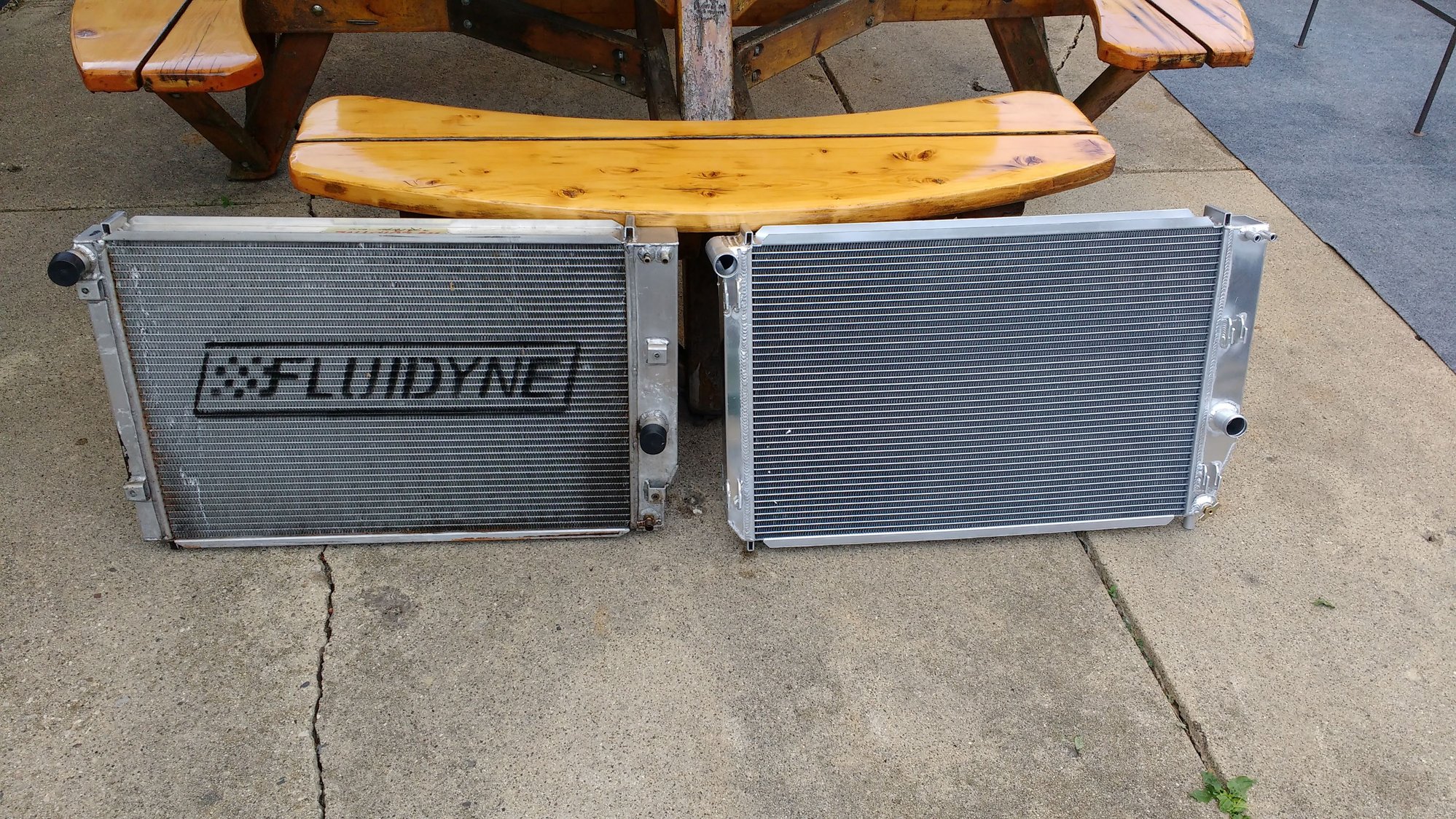

My ECP manual trans radiator is going on 5 years, so far all good. Had a 17 year old Fluidyne that failed and they needed the old radiator to duplicate since they don't stock Corvette radiators. The ECP was a cheap replacement until I got the Fluidyne back. I still have my old Fluidyne that I never sent in, lol.

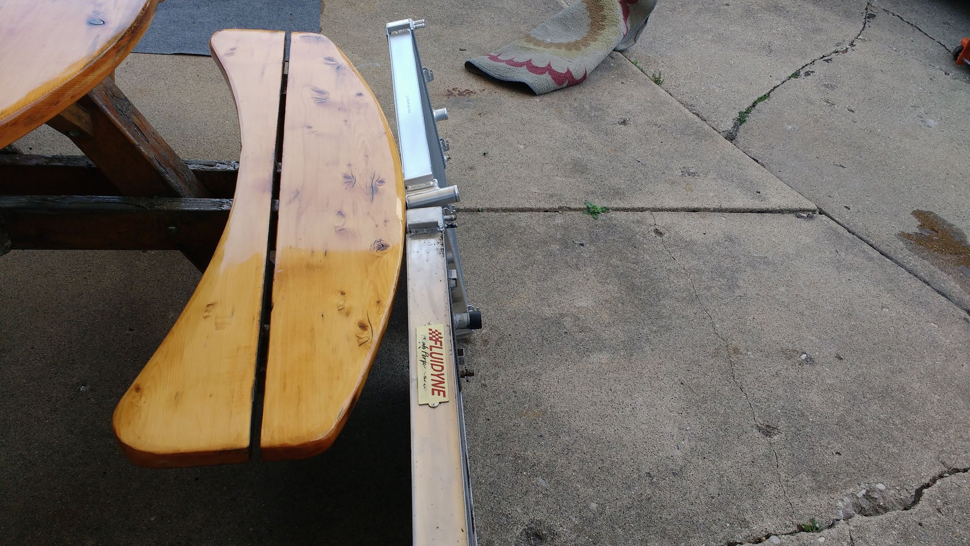

I stand corrected, actually 4 years on the 4th of this month, found a pic
