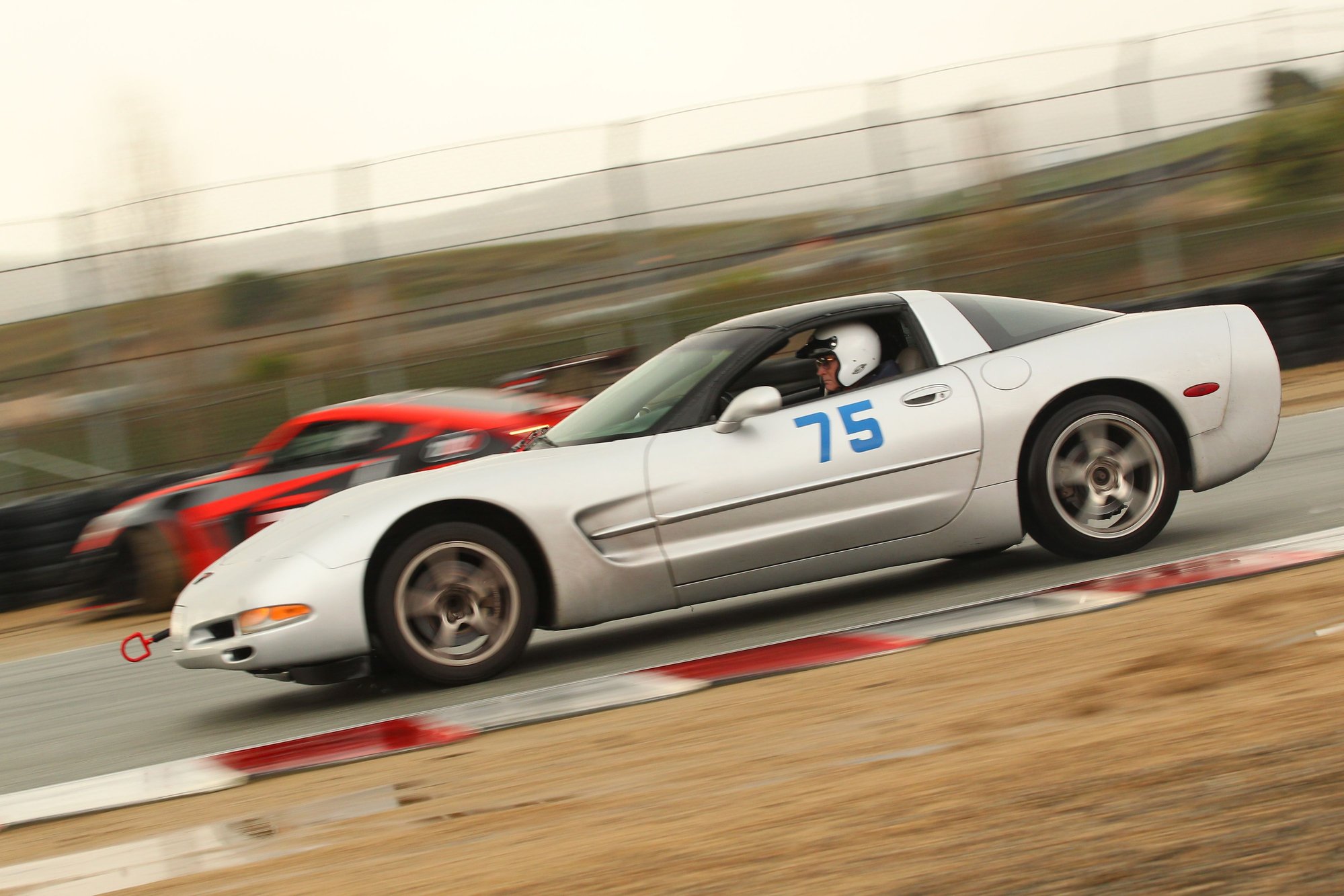

In my view, these cars are amazingly reliable, especially given their age. My solution is to fix things that break ASAP!
And floor it as often as I safely can.
I have enjoyed this car more than any car I have ever owned. I am a tinkerer, a repairman, a driver of some disrepute. Minor projects accomplished include the following, most done by me but some, marked with an asterisk, were done by others. It takes six minutes to have the car in the air on jack stands in my garage and then I'm off to do whatever needs to be done.
August 26, 2009- purchased from Pam; Pam, thanks for the car.
September '09- New HVAC Controller
October - New Brass Headlight Gears
- Auxilliary Satellite Radio Receiver
December - Replace Park Brake Lever, Adjust. park brakes
- Iridium Spark Plugs, wires
- Screen under cowl to permanently keep mice OUT
January '10- Four Wheel Alignment *
February - Water Pump
March - Clean and dielectric grease all grounds
May - Auxiliary emergency hood release cables
- Pulley and tensioner bearings, two belts
July - Redline Lube in differential
- Insulate interior floors
August - Ignition Switch *
September - Blower Motor *
October - Water Pump #2
March '11- Flush Brakes
- TRACK DAY 1, No. 66 at Buttonwillow Raceway
May - Brake Pads *
July - B&M transmission Pan, Redline Fluid
August - TRACK DAY 2, No. 66 at Buttonwillow Raceway
October - Sway bar links, clean and grease sway bar bushings
January '12- Oil Pressure Sender Unit
March - Rear tires, Michelin Pilot Sport, non runflat, two TPM senders*
- TRACK DAY 3 No. 67 at Buttonwillow Raceway
- Front tires. Michelin Pilot sport, two TPM senders*
- TRACK DAY 4, No. 67 at Buttonwillow Raceway
May - Secondary Air Check Valves *
- Last significant rattle, creak, squeak FIXED!
June - Tow Hook Receiver, Tow Hook
July- Dec -Cancer diagnosis, Doctors, Hospital, Operation and Recovery
March '13- Flush Brakes
- TRACK DAY 5, No. 68 at Laguna Seca
May - Ignition Switch #2*
- TRACK DAY 6, No. 68 at Buttonwillow Raceway
June - Friction Master Ceramic Brake Pads (turned out to be a mistake)
August - Check front alignment, add smidgeon of toe in*
- Flush Brakes, Ate Super Blue racing brake fluid
September - DeWitts racing radiator, hoses and Surge tank installed
- Change transmission fluid and filter
October - TRACK DAY 7, No. 69 at Laguna Seca
December - Hawk HP Plus brake pads
January '14 - TRACK DAY 8, No. 69 at Laguna Seca
April - Rebuild Front Calipers, flush brakes, install speed bleeders
May - Replace four slightly bent wheels with exact same used good wheels*
July - TRACK DAY 9, No. 69 at Laguna Seca
December - Auxiliary transmission cooler and fluid thermostat
- New front Michelin Super Sport tires*
- TRACK DAY 10, No. 70 at Laguna Seca
April '15 - Flush Brakes, Ate Typ 200
May - Hook up engine oil cooler
- Insulate tie rod ends and lower ball joints
June - TRACK DAY 11, No. 70 at Laguna Seca
- New Michelin Pilot Super sport tires on rear
- Corvette turns 100,000 miles, 800 miles on the track
September - TRACK DAY 12, No. 71 at Buttonwillow Raceway
April '16 - New 3.73 (RPM Transmissions) rear drive with Wavetrac differential, new shift cable*
- Doug Rippie Motorsports Bilstein Shock Absorbers all four corners
- Reprogram Power Control Module*
- Flush Brakes, Ate Typ 200, 500 mile lube change on rear drive
May - Change transmission fluid and filter
- TRACK DAY 13, No. 71 at Laguna Seca
October - Hawk HP+ brake pads on front
- TRACK DAY 14- Rained out
January '17- Replace accessory belt, AC belt
August - Insulate under intake manifold, relocate oil pressure sender unit, add rear head coolant air bleed lines
- Change coolant, thermostat
- TRACK DAY 14 at Laguna Seca No. 72
December - TRACK DAY 15 at Laguna Seca, No. 73
January '18- Rotator Cuff surgery, four- six month recovery
May - New front tires, Michelin Pilot Super Sport, check alignment*
June - Flush brakes, Ate Typ 200, check pads
- Four wheel alignment*
July - Track Day 16 at Laguna Seca, No. 73
January '19- New Stop Tech slotted cryo treated rotors, HP Plus pads on front
February - TRACK DAY 17 at Laguna Seca No. 74
March - Carpal Tunnel Surgery
July - TRACK DAY 18 at Laguna Seca
December - TRACK DAY 19 at Laguna Seca in the RAIN, No. 75
May '20- TRACK DAY 20 at Laguna Seca- CANCELED- Corona Virus
June - Flush brakes Wilwood EXP 600 Plus, DBP 594 degrees, WBP 383 degrees
July - Sold Ranch! all hell breaks loose.
August - Three cars and 11 tons go from Arroyo Grande to Prescott Arizona. August 9, escrow on Prescott home closes, we arrive on the 13th.
October - TRACK DAY 20 at Arizona Motorsports Park, No. 76
February '21- TRACK DAY 21 at Arizona Motorsports Park, No. 76
March - HP Plus Pads on the rear
April - TRACK DAY 22 at Arizona Motorsports Park, No 76
Next- Check out other race tracks around Phoenix, Johnny O'Connell Sway bar set, Install Halltech cold air intake, check tune.
