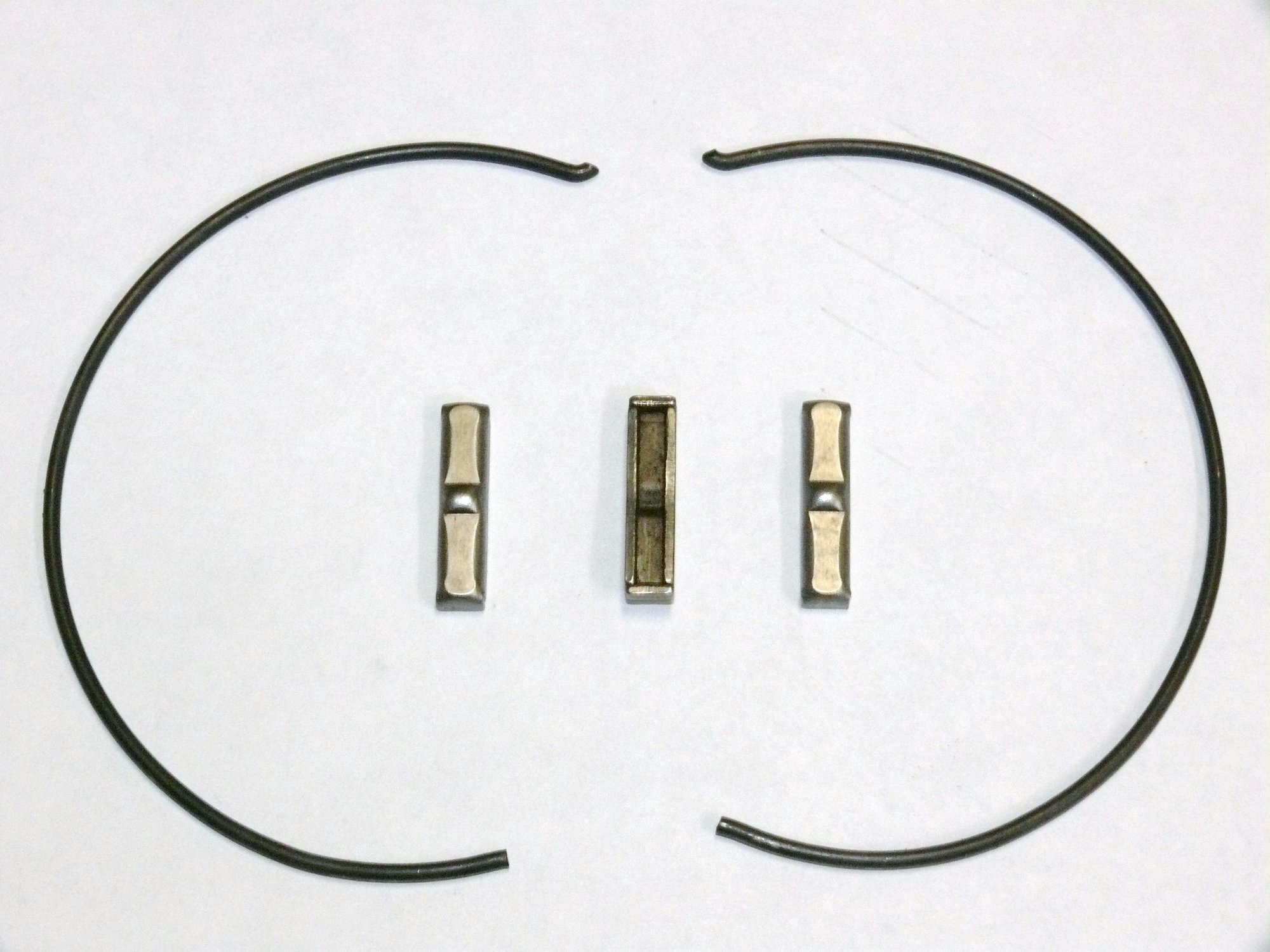

One of your stamped “keys” is sheared and is jamming up the works. I had the same thing happen to me back in 2003. Your transmission will need to come apart to repair it.

Locks up in 2nd as well as 3rd/4th.
The cheap bent sheet metal keys commonly split and get jammed.
