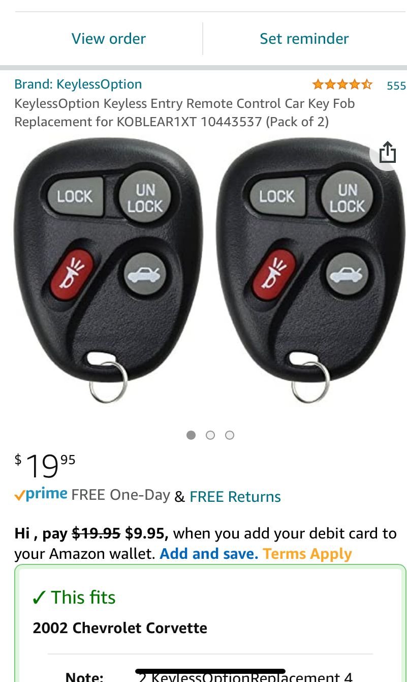

These are what worked on my 02

Paul , They made two different key fobs for our cars. one is affordable the other is over 100 dollars
you may find that the new ones you bought will not work. If they do not you will need the other fob

There are ones for the 97-00 and ones for 01-04. The ones I showed work on an 02. Correct?
