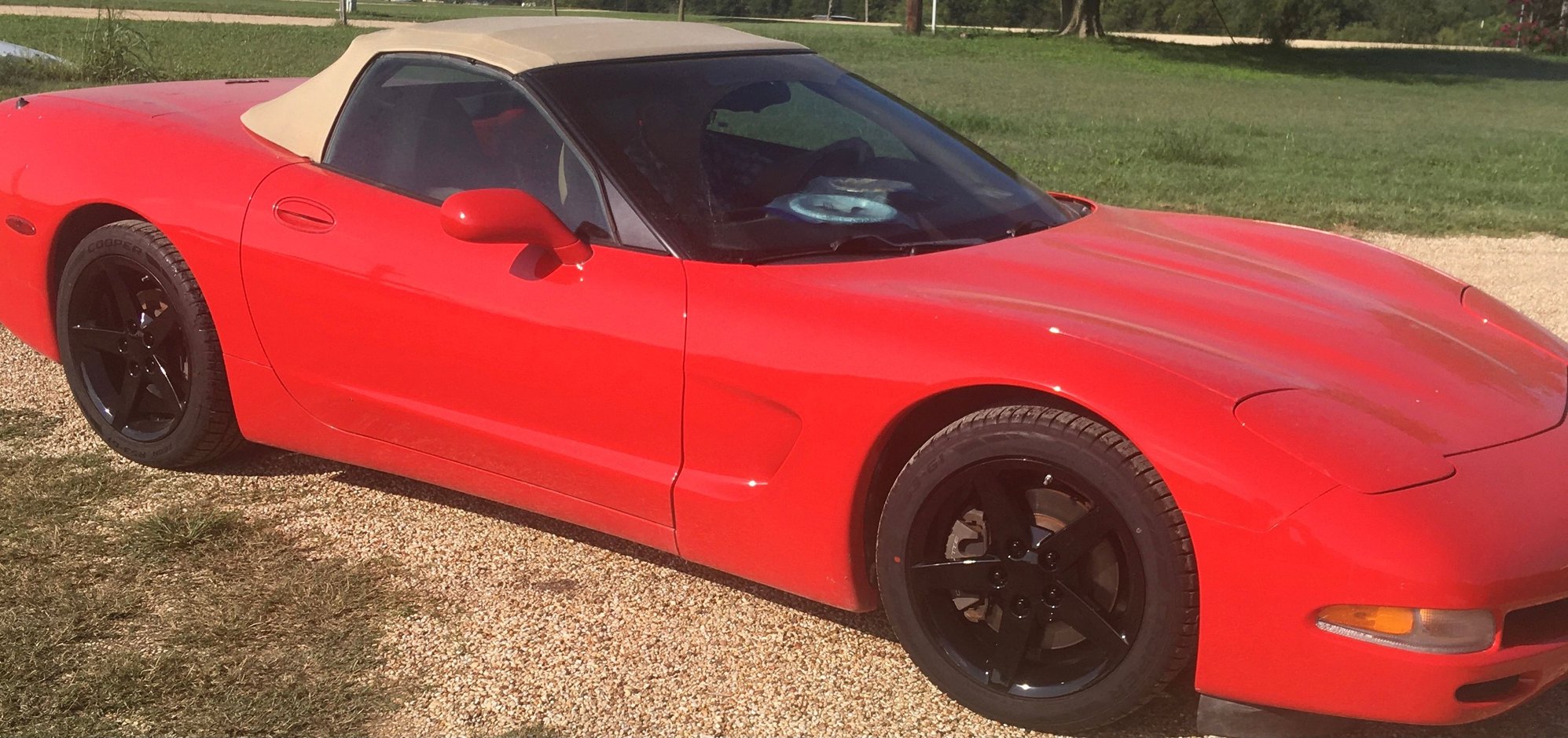

I bought these black ones for Dad's 2000 model from Ecklers ecklerscorvette.com . Set was around $600 a couple years ago. They have several chrome options on their site.
Last edited by Dads2kconvertible; Sep 10, 2021 at 07:53 PM. Reason: add year of car
