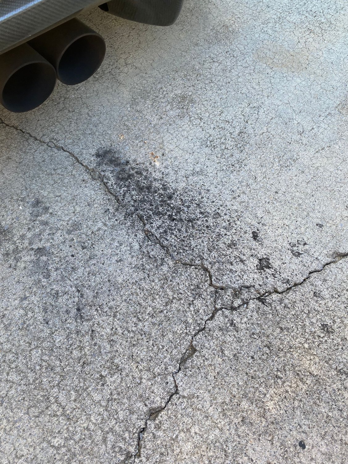

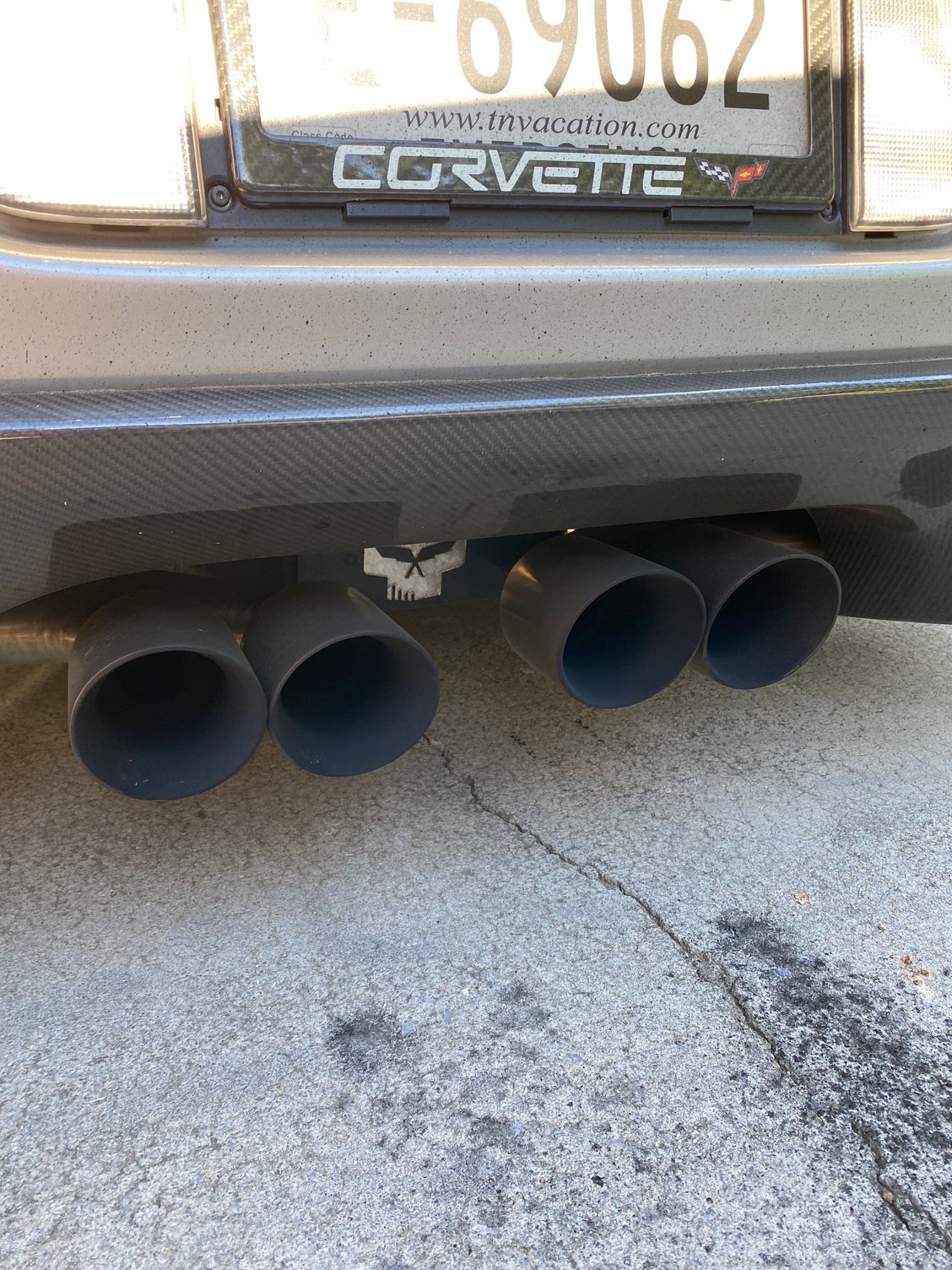

So does anyone else have a problem with choking on exhaust smell in the car while driving like its leaking into the cabin?! It a full texas speed long tube and catless xpipe back to a BB Fusion system. I feel it may be a tune issue being set WAY to rich, but could also be the slip joint exhaust but I have even tried the wider bands to clamp it all.
This ia from starting it this am.
These are supposed to be shiny. It doesnt matter if it was a short drove after or days after cleaning them they look like this.
And this is ALL OVER the back of the car.

Definitely a fueling issue.I have almost the same exhaust and mine stay clean.An exhaust leak may cause the smell but not the black soot.

Must be dumping alot of fuel into the engine. Does your oil smell like gasoline. Sure way to damage the engine if you keep on driving it like that.

Definitely a fueling issue. Might be worth checking your injectors and make sure you don't have one stuck open. If the injectors are good you should take it to a reputable tuner and have it properly tuned.

Injectors were brand new installed from FIC

My car is doing the exact same thing, and i dont have an answer. My plan is to have it retuned at a different shop in the spring next year.

Exhaust donuts wear thin / catalytic converters clog / breakdown…if the car was tuned it may be fuel rich

Injectors could be brand new, but if it's tuned rich, OR lean, it just eliminates/reduces the bad injector variable. If tune is off, it won't matter how new the injectors are. Could also be a wild cam, which is hard for any tuner to get engine running right at all speeds.......
