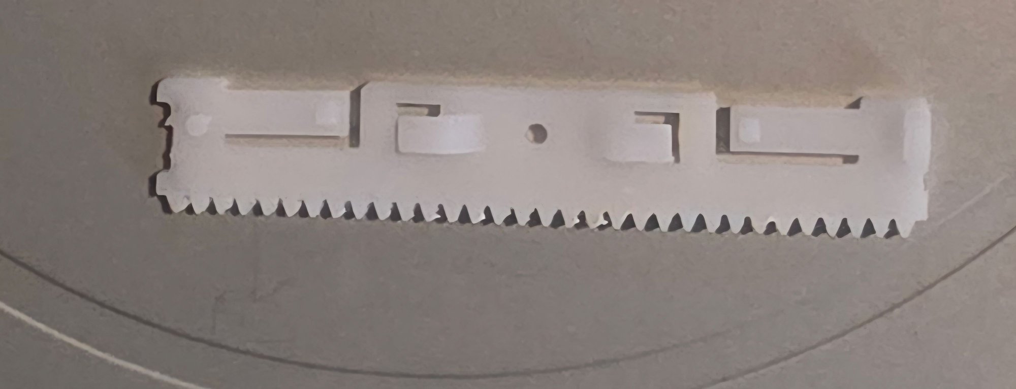

Default Lose part
I tried all troubleshooting until I had the discs drawer stuck in the unit.
So, I opened the unit and found a lose part. See the picture. I can't find where it fits... Thinking seriously to give it up.
Have you considered the repair guy listed throughout these post? I went ahead and agipped mine off. This guy fixes to work with original mount and it worked great. It's not the one who has you change the mount.

Originally Posted by bjones7131
My friend's 12 disc CD changer isn't working, he said it had a cd hung up. He doesn't want to deal with it so do you guys know of a company that repairs them. From my research not many guys work on them and they aren't very reliable and pricey. Any suggestions, thanks!
Thuy NguyenDelco and Import Department Managertnguyen@unitedradio.comwww.united radio.comPhone: 800.448.0944 EXT. 3275Fax: 315.446.2434
Fixed mine, fast and uses original mounting.

Default 12 disc changer repair
Just had my 12 disc changer repaired by United Radio located at 5705Enterprise Parkway in East Syracuse, NY. The cost was only $275.00 to repair the jam and $100.00 to repair the audio output, plus they paid the return UPS shipping cost. Contact Thuy Nguyen at United Radio, his phone number is 800-448-0944 ext. 3275 or email tnguyen@unitedradio.com The turnaround was very quick, I think it was only in their shop two days.
