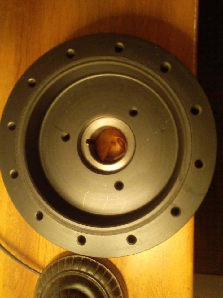

I went with the assault racing balancer for 91.77$ as much as the stock replacements. Im waiting till it warms up hopefully feb-march before replacing with the elgin 1839 220/224 cam. Im going to do a compression test before to make sure the heads are in good working order and ordering a set of pac 1219s and pushrods to install at the same time. Came with a woodruff key.

I weighed this balancer on a bathroom scale compared to a stock f-body balancer and there about the same the f-body says 10lbs the assault racing shows 11lbs so not much of a difference. Is there any reason not to use the dorman 4$ balancer bolt?

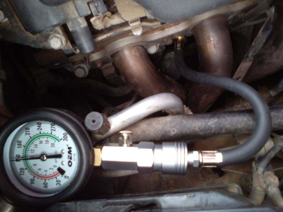

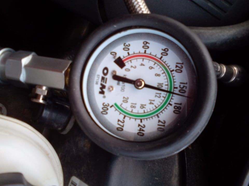

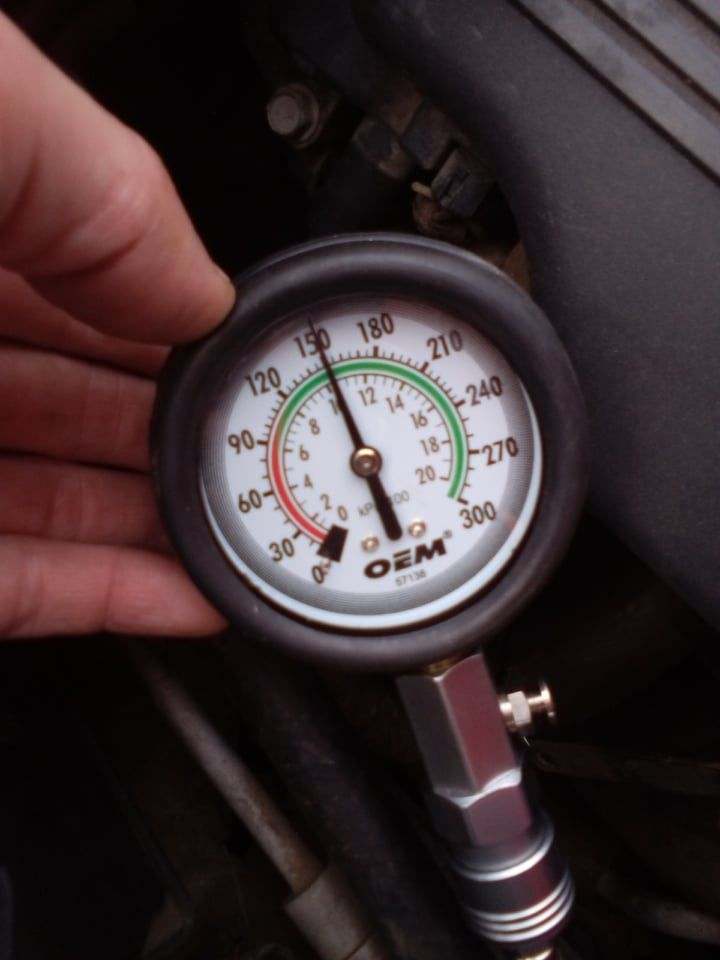

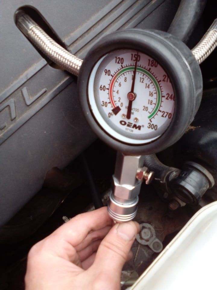

I was doing a compression test this morning and they all test around 150psi. Is this normal for a stock ls1 engine? Was making sure i didn't have bad cylinder rings or bad valve seats. One valve may i mention when i was putting the tsp headers i had stuck an autozone magnet which then pulled a small piece of valve material off of the driver side 3rd back exhaust port. Today i pulled all the plugs and the one plug does have some oil. I swapped the plug with the one next to it to see if it does come out oily next time. I guess it wouldn't have a burnt or exhaust valve if it did have 150psi. I failed to mention this. Every new bosch platinum plug was burned clean when i did the headers a few months ago but was fishing around for bolts and the extension magnet had pulled off part of a valve thru the exhaust port. If its pumping 150 psi with the rest of the cylinders but does have oil on the plug what could this mean? You can see where they wrecked it and had the frame pulled. Mind you i didn't notice this till installing headers as well as lower radiator support half missing and a fan blade hanging loose. The headers i was repairing an exhaust leak was all he mentioned it had 2-3 bolt broken in the exhaust manifold it turned out that one stud on each exhaust manifold cat side was broken off and a rear intake bolt was stripped or wouldn't torque passed 5lbs. It doesn't pose any problems i suppose just wish he would've disclosed this stuff before as the torque tube was trash as well. I did a vin check showed a wreck from somewhere in 2009-2011 and the rack and pinion has a upc with the date of 11/11 2009 or 2011 i just seen.

Im thinking the compression tester may be off a bit. I did the teaspoon or oil in the cylinder trick compression didn't change one bit. So im assuming the rings are good. I read other threads where some compression testers read off a bit. Im wondering if my new balancer with the 3 holes for slotted pulley pulley removal will work with the classic style harmonic balancer holder. Summit Racing SME-906007 Summit Racing™ Harmonic Balancer Wrenches | Summit Racing as the ls1 puller has three dowels aligned a believe for factory style pulleys. This you would have to drill two holes atleast if they were off and i believe 1/4" bolts to hold it while torqueing to 235 ftlbs per arps spec.
