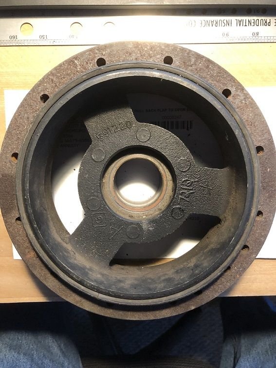

This does look to be the factory seal and part of it stuck to the balancer wearing a groove into it as well as factory bolt? Im guessing its the stock seal and probably balancer and bolt as well as to why the front cover was coated in sludge. I have a fel pro front cover gasket kit. Now im going to be installing a cam so just coat it in assembly lube and its fine to reuse the stock thrust plate or do you guys usually replace it with a new one? Theyre 18$ on amazon. The cam bolts dont use any loctite just torqued to correct specs and for the front cover leave all the bolts loose until the balancer is torqued and you torque the oil pan bolts first to front cover then the rest of the front cover bolts and fit silicone on the corners of front cover to oil pan gasket seal? I did install one on my old 98 z28 but that was in 2011 and reused the stock thrust plate new front seals with ud pulley but i believe i centered the front cover by installing the balancer then torquing front cover bolts and never had an issue. The problem with this is you have to remove the rack and pinion and can't afford to make that mistake. Im going to order the 15$ amazon flywheel locking tool i suppose to torque the balancer to 240ft/lbs. The impact would work as it removed the bolt easily just dont want to hammer on the crank so ill be trying to find a torque wrench that goes to 240ft lbs? Any idea where you can borrow a 1/2" or 3/4" torque wrench that goes that torques that much. I could pick up a dorman 7$ bolt at autozone and just measure it with degrees but then would have to worry about the bolt stretch and coming loose.

My car only has 37K miles and had a similar groove in the pulley from the seal. Mine sat a lot though so I wonder if it was more of an age thing hardening the rubber vs actual wear. Mine spends a lot of time around 7000 rpm though, so it spinning pretty fast in that hole lol.

Hey yes i got the rack out of the way but can anyone identify is this is a dorman balancer or other stock style? Part number is 591220. Its not in too bad of shape other then the groove worn into it. Im going to replace the front cover seals but curious if this balancer was a good one. This should fix the oil leak from the front cover as well as i was just in here to install the cam. Id hate for the aftermarket professional products or ar one i purchased to have a wobble or something else wrong with it. That rack is a pain. My gauge cluster says 92,600k miles but never know as its a rebuilt title. I too think the seal is aged. My 98 z28 with 140k miles in 2011 didnt have any wear into the stock balancer.

My OEM unit says 591220 also. Not quite as many balance holes as yours. Has a large letter "A" and a "G" embossed in a diamond design as well as 7212 and the letter "X" on another leg.
Thats great new so its ok to assume this is the original ac delco gm balancer and seal thats maybe never been replaced?
