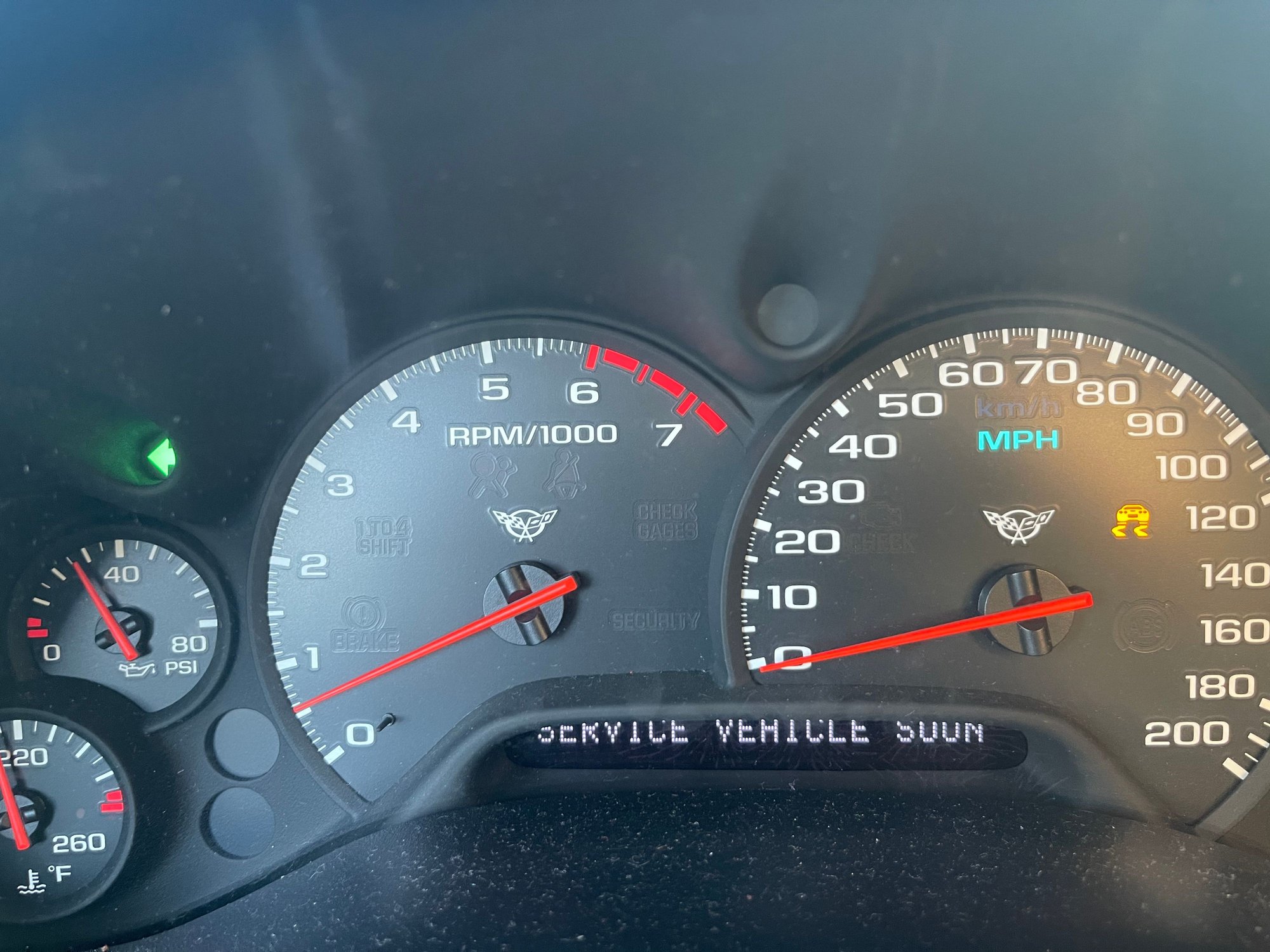

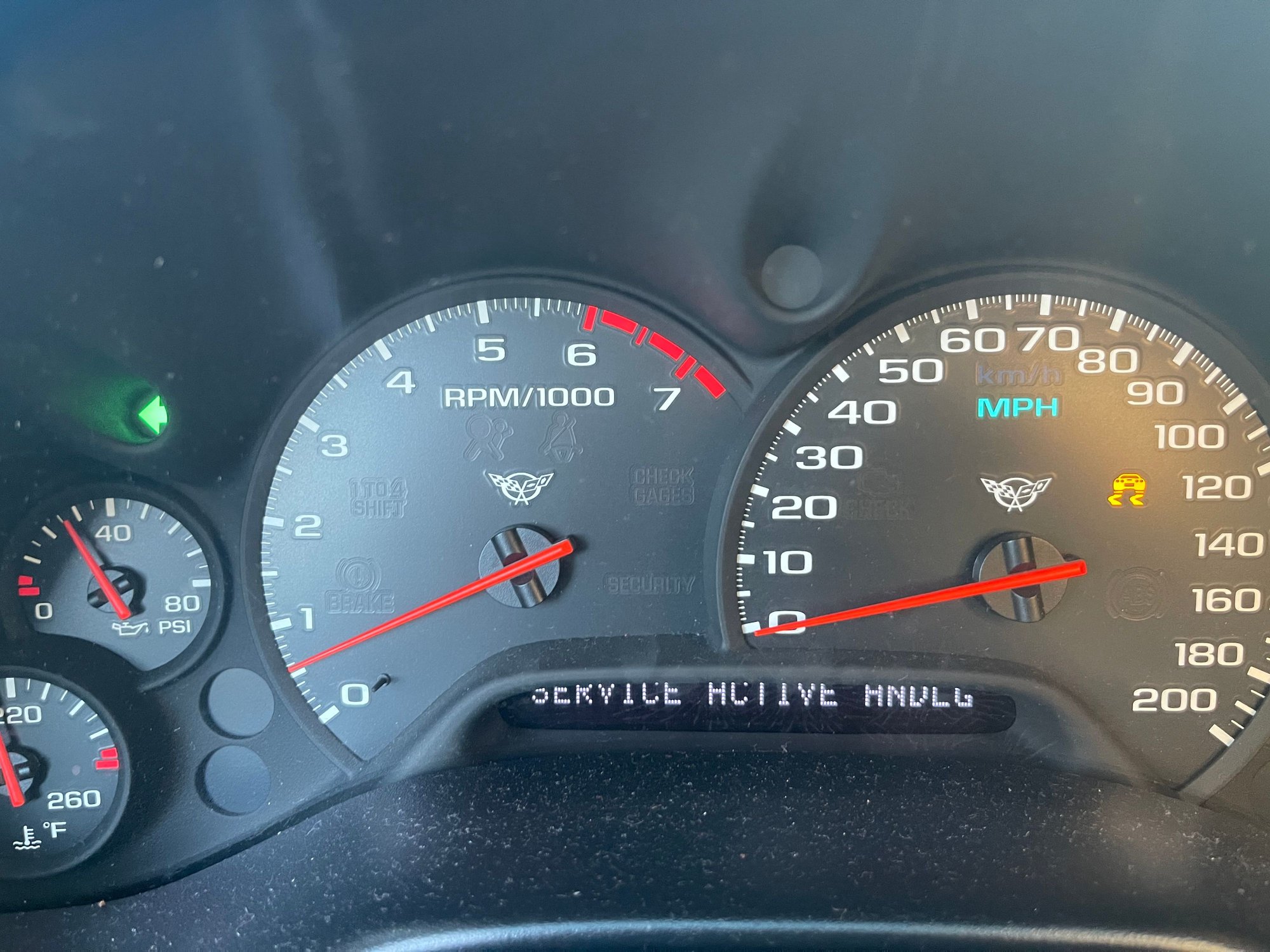

On our way back from a short ride today this came on the screen. Should I bring it to the dealer? As usual thanks for your knowledge on this forum.

I'd start with cleaning my engine compartment grounds.

Did you hit any bumps during the short drive? Was the car recently on a lift? Did your battery get low due to low temps outside? All of these can cause the error to populate.
Did you cycle the ignition to see if it went away?
Have you tried to pull your codes to see which codes are coming up? Which codes are you getting?
Finally, did you clear said codes to see if the SAH message goes away?

PS...try every possible DIY fix and get advice here before outsourcing to a mechanic. And NEVER bring it to a dealer unless you are EXTREMELY desperate. Even then I advise against it. Dealer Tech's are hacks and the car being 20 yrs old most dealerships will consider it a no fly zone.
SAH errors can come up for a dozen reasons. The majority are just a communication disruption. That which fix themselves and just require a code clearing.
As mentioned above grounds can and often times are cause for this error as well..
Start with the easy stuff that's free.

Last year on first drive after winter sleep service traction control and active handling message came up.
Got back home and took a chance at cleaning engine compartment grounds and I cleaned the passenger side frame rail ground first and that fixed it. Cleared codes and never had an issue since.

If you're getting these codes, are you also getting "active handling warming up?" If you are, it may also be the steering sensor.......

Sure, it could be the SWPS. But I wouldn't be worried about that rabbit hole yet. That error pops up sporadically on a lot of these cars for simple to solve reasons. I've cleared that code dozens of times in 22 years.
First he needs to pull the codes, attempt a reset and clean the grounds. Eliminate the free and easy stuff first. Then move on to the headaches.

It's sporadic for me and a reset erases it. Only had the persistent recurring issue once. Ground plug wire was slightly backed out of connection. Prongs not making full contact. Plugged her in securely and persistent SAH message went away.

It was probably temporary due to a temporary communication failure. It's pretty common to pop up here and there. Cleaning your grounds will help mitigate the random message coming up.

My 2000 throws the light pretty regular if I park with the steering wheel fully turned and power down. Like clockwork, I get the light when I start it next. The light stays on for that operating cycle. If I park straight (or at least not full lock), the light does not come back. It’s been doing this for about 3 years. I consciously try not to park full lock, but sometimes it can’t be helped.

Your description points to the SWPS. Sounds like you found a decent bandaid to mitigate occurrence.

Mine was a wires that was worn away on the side underneath the center console area tapped it up and it’s good as gold …
