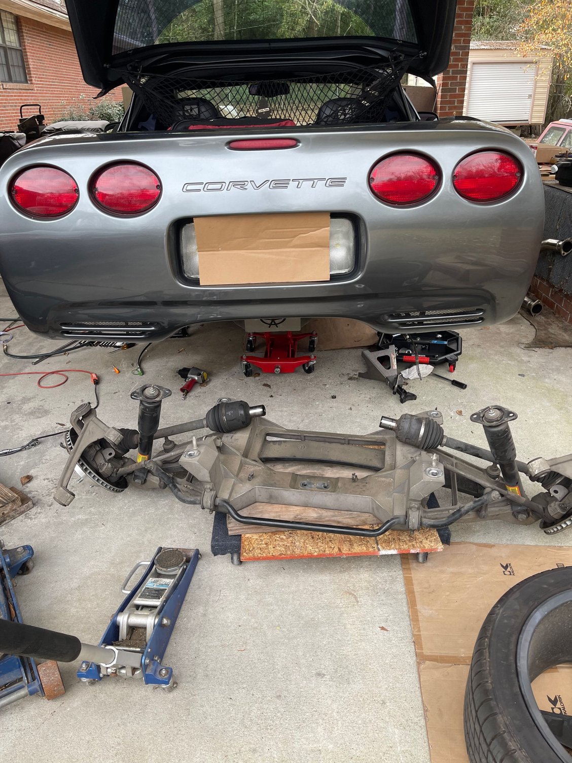

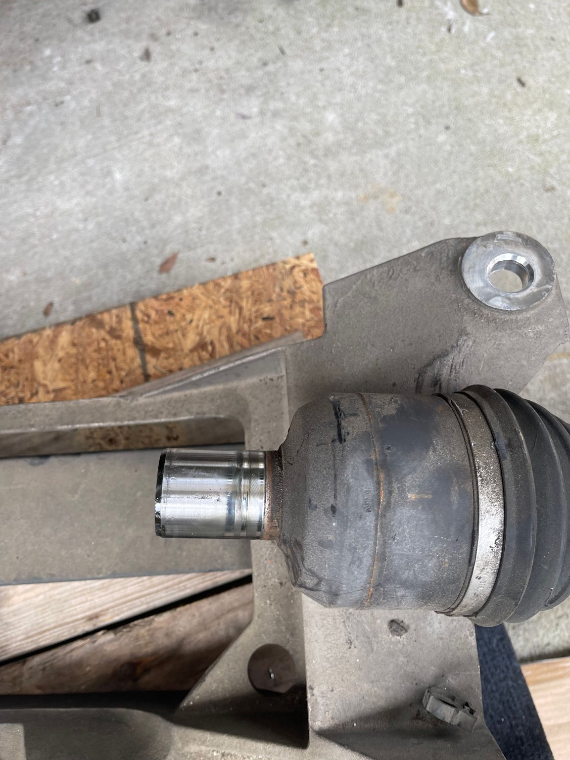

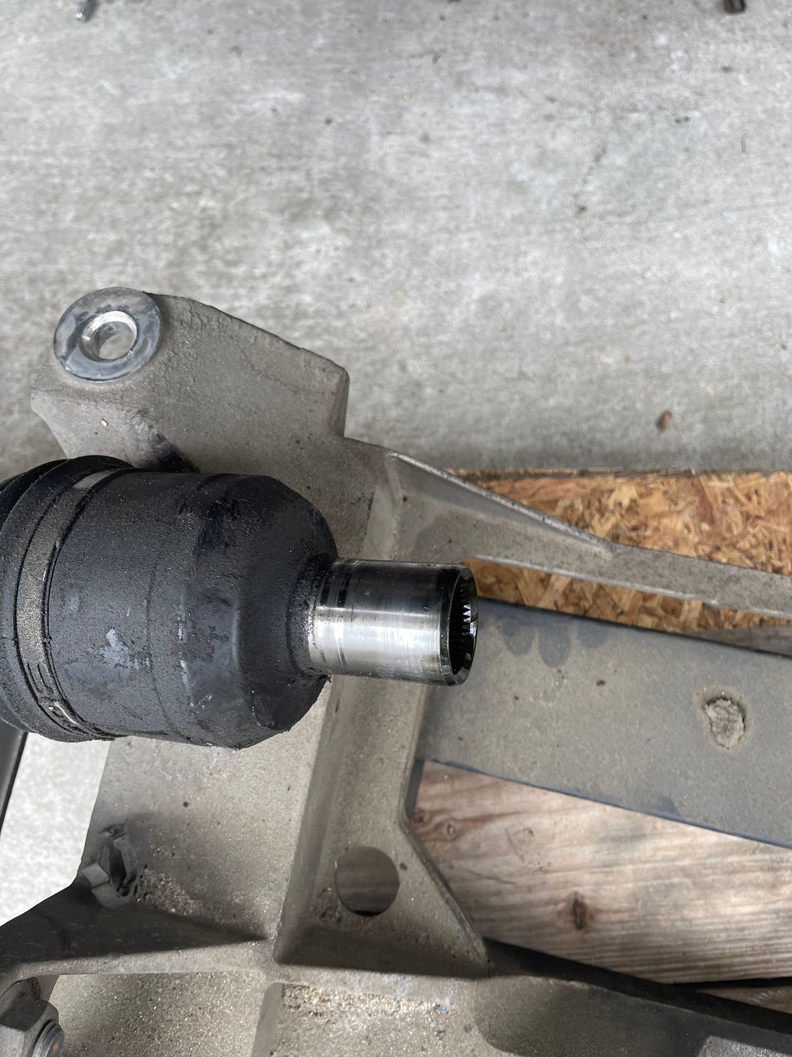

I got the Vette up on Quickjack let’s and dropped the exhaust, tunnel plate and the lower cradle. My diff is covered with thick black dust, but it is not wet. When I droc
ve it on Monday, I smelled differential oil, but found no active leak. When I pulled the axle shafts, I found grooves on the output shafts. No leaks, but the grooves look kind if deep on the o
pasenger side. Should I replace the axle shafts or will I be ok to continue to use them? Any advise would be appreciated.

Old Feb 2, 2022 | 07:10 PM
jpb1978's Avatar
jpb1978
Joined: May 2017
Posts: 228
Likes: 35
You can get new GM axles for about $300. each. I don't think the are too hard to replace so the choice is yours to do it now or later.

I just wanted to update the thread. The driveline is on the ground just ahead of much rain and a temperature drop. One thing is sure, this is a lot of work for one man on Quickjacks! Doable, but labor intensive. After a week off I will return to remove and replace the rear main seal, flywheel and clutch, rebuild the torque tube and possibly change the rear axle shafts. Frankly, axle shafts are not in my budget, but I must clean up and reseal the differential. I'll post some pictures for advice. You guys have been great. More to be forthcoming.

I did it all myself on the garage floor with jackstands and a transmission jack. I was sore for a good week or two afterwards, but it got done!

I worked on the Torque tube yesterday. Man, is anything easy on the Corvette?: The BF snap ring took me four hours to get off, then the rear coupler did not want to come off due to some rust on the drive shaft. What a day!

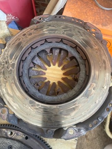

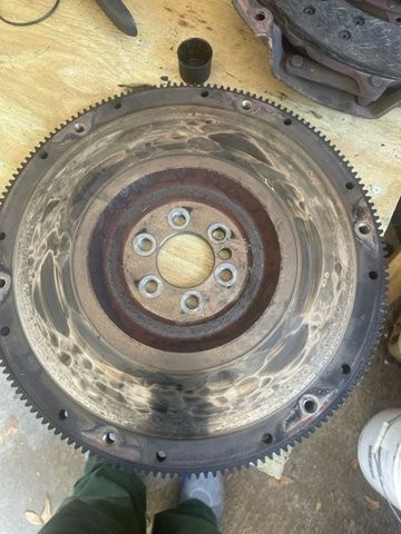

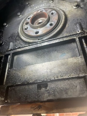

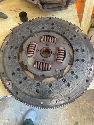

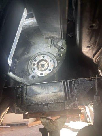

Well, I'm back! the clutch is out, the rear main is installed, The LS7 clutch and pilot bearing installed, and I now have to reinstall the bell housing. I had to remove it because I could not get the rear plate bolt started, cross threaded one of the bolts, and had to get the bell housing out of the way to make things right. Did I mention that nothing is easy on the Corvette? Any way, here are few picks of what I found:

Dang man...that clutch was smoked!
Yeah, I think some oil got on it . I cleaned up the rear of the motor, installed a new rear main seal and I am keeping my fingers crossed. I do not want to go into this thing again.
