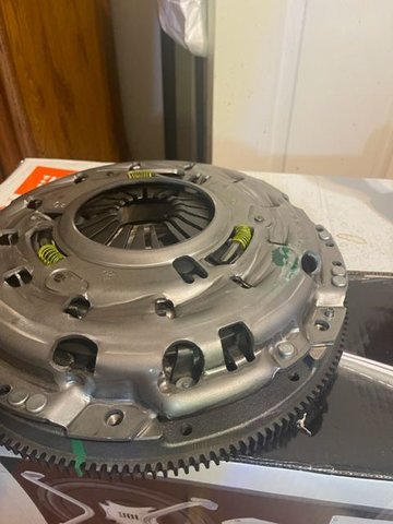

Greetings!
I am about to undertake my clutch install as soon as the weather breaks down here. I have all parts with the exception of the torque tube seals, which are scheduled for Wednesday. I have my LS7 clutch kit, a Dorman slave cylinder, a GM master cylinder and a Tick performance remote bleeder. I also have the rear main seal kit and a centering tool as well as a new barbell. I have the Tick Performance torque Tube rebuild kit. My latest question is I have read that the LS7 clutch kit comes balanced, with a mark on the flywheel and on the pressure plate. However, the marks do not line up exactly. Do I install it as close to the marks as possible, or do I seek another solution? All advice will be appreciated.

can you post a picture of how the marks appear?

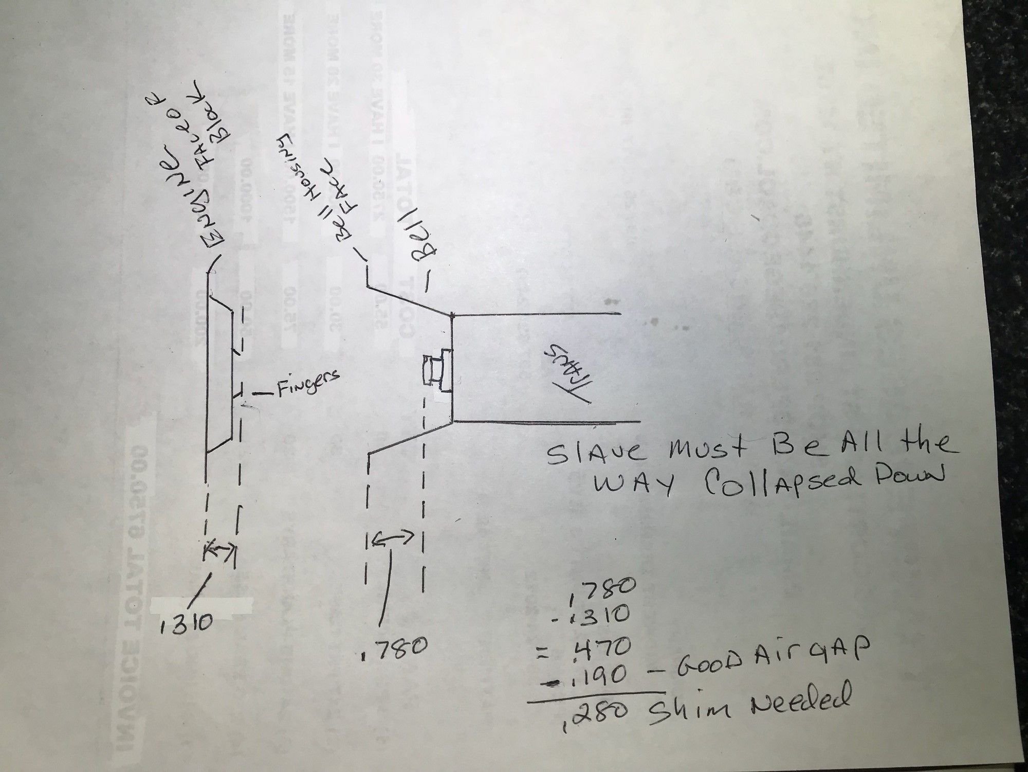

Make sure you check the release bearing clearance and add a pedal stop. numbers shown are for reference only.
Sorry for the delay. I was out of town on business. Here is the photo. I got the kit from Amazon.

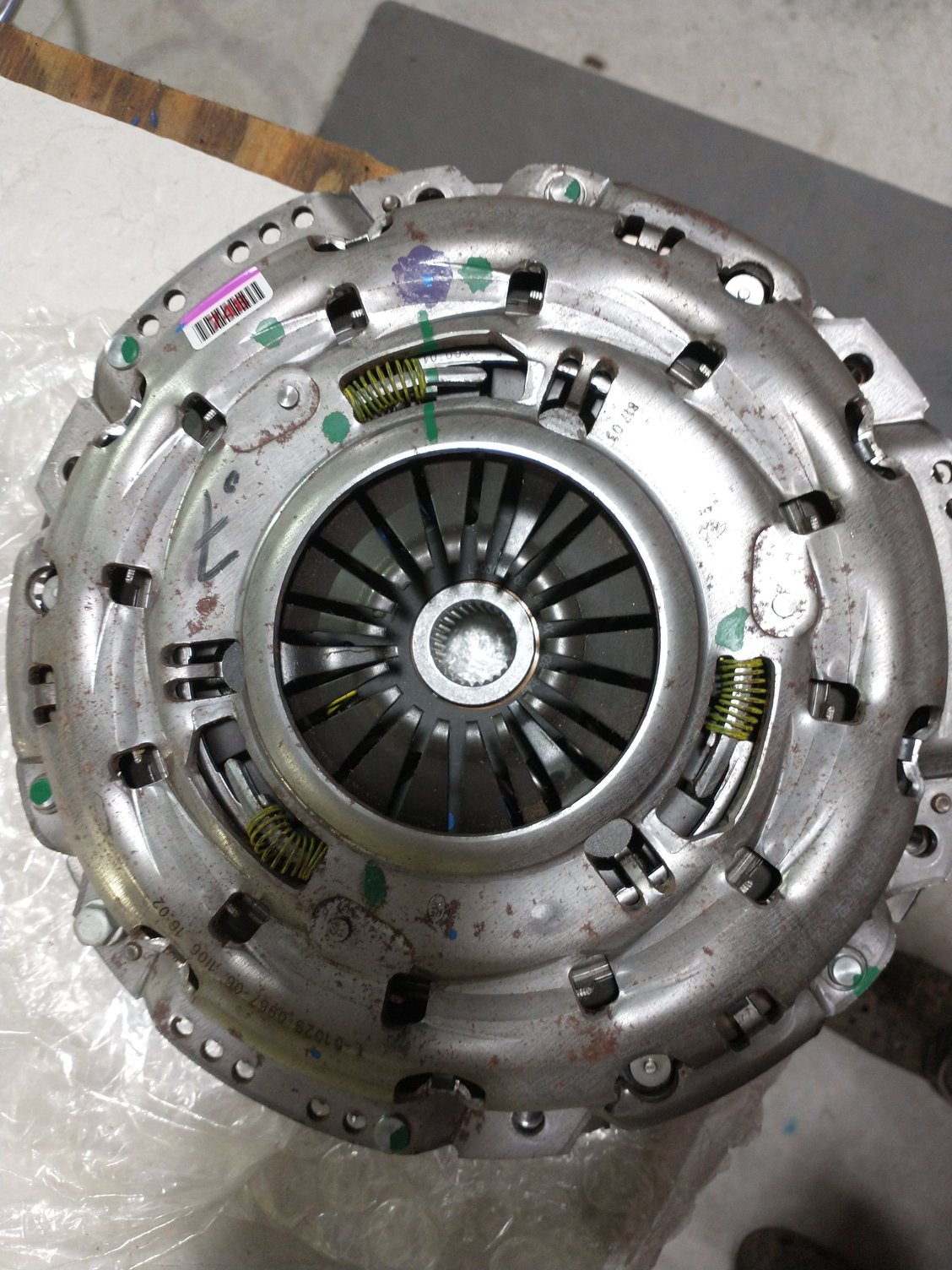

I don't think that the clutch is balanced with the flywheel. That's a LUK kit, right?

I'd be suspicious that there was some mix n match going on with that... I don't think I'd install it with the marks so far off from each other. Send it back.

These are pics of a LS7 clutch bought from a GM dealer, it has the same bunch of paint marks on it that don't line up or make sense.

Good info above. Perhaps it's fine to use as is. But, I still question, how do you know how to align the pressure plate with the flywheel? Is it indexed in some other manner to prevent improper orientation?

Since when the hell does a single plate clutch need to be "balanced" or "matched" to a flywheel? That's what the alignment dowels are for. I've done two dozen or so clutch jobs on various cars (even some true rotating assembly dynamic stuff) through the years (and on both of my ZO6s) and never once, was that a thing. If that WAS even a thing, the moment you took it apart to install it, it would introduce imbalance. Not to mention, the friction disc, TOB, etc. and their imbalance introduced into the picture. What tool even exists to "balance" a clutch and flywheel that are bolted together on a spinning crankshaft?
@OP, bolt her in, torque them down, check your TOB measurements, and go. Paint marks are ambiguous to say the least. Unless you're pulling the rotating assembly out entirely to do a full dynamic balance, there is ZERO reason to be concerned...especially when replacing with an OEM clutch assembly.

It's not the disc. It's the pressure plate which remains fixed to the flywheel.
The C5 is quite sensitive to vibrations as a result of the torque tube / rear trans design. Extra steps were taken in the flywheel balance in original assembly to prevent this.

C5's aren't the only Corvettes designed that way. And it's all irrelevant because he's not putting the same clutch back in it.

There was some balancing done on the original clutch set, and if removing and later reinstalling it you are supposed to mark the components and put it back the same way.
If you have a GM LS7 clutch kit just bolt it in and you’re good. Some have been reported to vibrate, but that’s an outlier.
I checked Amazon and the only authentic GM LS7 clutch kit I found was the clutch and pressure plate only; no flywheel. Are you certain it is GM, or is it “GM OEM” ? If it’s OEM, it’s probably a Luk brand, which is not all bad, in fact I believe they manufacture parts for GM. Still, even if it’s a Luk, I hope you got a complete set including flywheel and pilot bearing.
You must use a matching LS7 flywheel with this clutch.

Greetings;
I appreciate all of the input regarding this clutch kit. I am currently dealing not with paralysis of analysis but paralysis due to weather. It is 27 degrees here in south Alabama and I am chomping at the bit to get this project started. I did recognize that iI purchased the wrong master cylinder and I returned it for a Luk unit. Now I am anxious to measure the slave cylinder gap to make sure we can install without too many complications. I will update as we go along.

Keep in mind this will be heavier than the C5 setup if you are planning on using a C6 flywheel. I use a Ram 2552 aluminum wheel with LS7 clutches to get the weight down. You will also need to loosen the bell housing to fit the pressure plate and disc.
