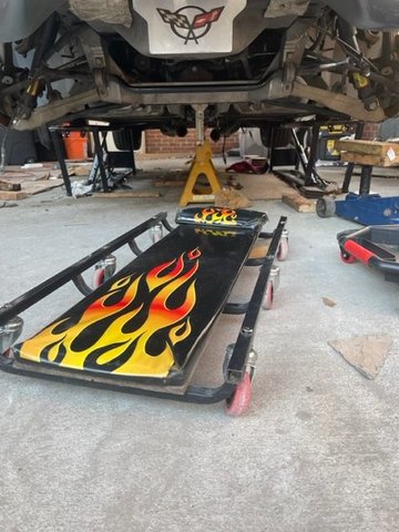

Default Almost finished!
We are close! This has been quite a journey. I have to reinstall the headers and exhaust, spark plugs, bleed the clutch and fire it up. Thanks to you all for your input and suggestions. I have to work the rest of the week, so we we hope to fire it up next week. We will keep your posted.
