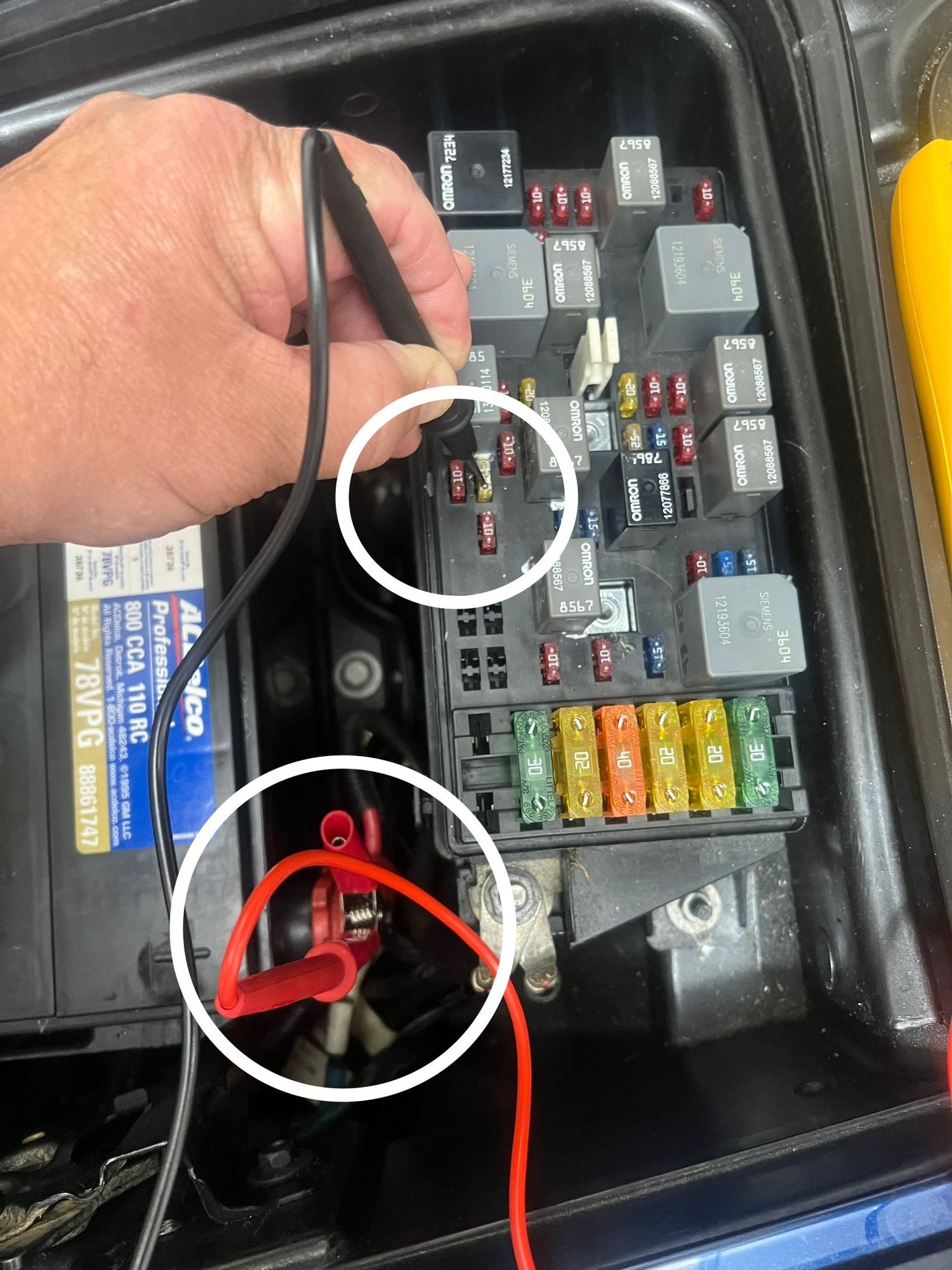

Old Feb 19, 2022 | 06:38 PM
TRPLBLKC5's Avatar
TRPLBLKC5
Joined: Feb 2022
Posts: 52
From: Colorado
fuse. crank attempt
13. 12.0
9. 0.00
14. 0.00
21. 0.00
Old Feb 19, 2022 | 06:44 PM
C5 Diag's Avatar
C5 Diag
Moderator, Tech Contributor
Posts: 15,621
Likes: 4,068
From: Cape Coral, Florida
Fuse 13 is the fuel pump fuse so I can’t see how you are dropping ALL of the voltage across the switch when you said you can hear the fuel pump run turning the key on…can you take a pic of your voltmeter set up for this ??…on the other circuits you should see some drop and not 0.
Old Feb 19, 2022 | 07:24 PM
TRPLBLKC5's Avatar
TRPLBLKC5
Joined: Feb 2022
Posts: 52
From: Colorado
set for 20 vdc. 13 I read 12 vdc when crank attempt.
Old Feb 19, 2022 | 07:35 PM
C5 Diag's Avatar
C5 Diag
Posts: 15,621
Likes: 4,068
Please take a pic of how you are connecting your voltmeter…on that ignition switch circuit you have injectors and coil packs being powered when you start the car so you should not be seeing 12 volts !!…is your battery FULLY charged and connections TIGHT ??…it may be best to take the car to a shop where they can check all the modules especially the PCM and BCM to make sure they are being powered up and also communicating…where are you located ??

you kinda lost me. fuse 13 fuel pump reads 12 volts with key turned. the other three you told me to check the same way drop to 0.00.

Old Feb 19, 2022 | 08:22 PM
  #35
C5 Diag's Avatar
C5 Diag
Posts: 15,621
Likes: 4,068
That’s not the fuel pump fuse but where is the black lead of your voltmeter going in this picture ??…if it’s not connected to the positive post of the battery you are hooked up wrong !!…you check the other fuses this way and you’ll need another person while they try to start the car…a LOT of DIY’s say how can you have the voltmeter hooked up to 2 power sources and read a voltage ??…a voltmeter reads a difference of potential between the 2 whether it’s on the positive or negative side !!

Old Feb 19, 2022 | 09:00 PM
  #37
TRPLBLKC5's Avatar
TRPLBLKC5
Joined: Feb 2022
Posts: 52
From: Colorado
I'll get someone to help me with the measurement. Which fuses you want tested are by the batt. and which ones are in the footwell?
I didn't know about reading dc voltage with two positives.

Old Feb 19, 2022 | 09:07 PM
  #38
C5 Diag's Avatar
C5 Diag
Posts: 15,621
Likes: 4,068
My apologies, fuse 21 is blank. I assume its in the foot well?
Yes, IP Fusebox !!

Old Feb 19, 2022 | 09:12 PM
  #40
C5 Diag's Avatar
C5 Diag
Posts: 15,621
Likes: 4,068
9,14, and 21 are IP fusebox…13 is fuel pump and is underhood as in my pic…reread post #21 !!
