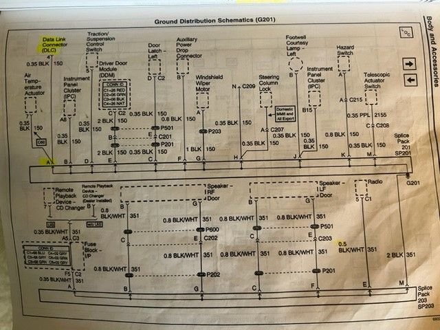

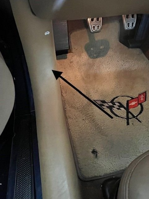

OK, try this...install both combs in the splice packs and take your voltmeter and probe any of the purple wires on the splice pack...the purple wires are the data line and each one goes to a splice pack...with the key on see if the voltage jumps around from .2 to .4 volts or so...if at 12 volts or ground that's not good...if voltage jumps around it may not be a serial data issue...now there are some grounds for the radio and cluster that are grounded at G201 which is at the bottom of the A pillar...remove the trim piece in the picture and there is a splice pack which is screwed into the A pillar and that is the ground...you will see 2 splice packs there...
pic enclosed...see if anything else on that ground is inop !!

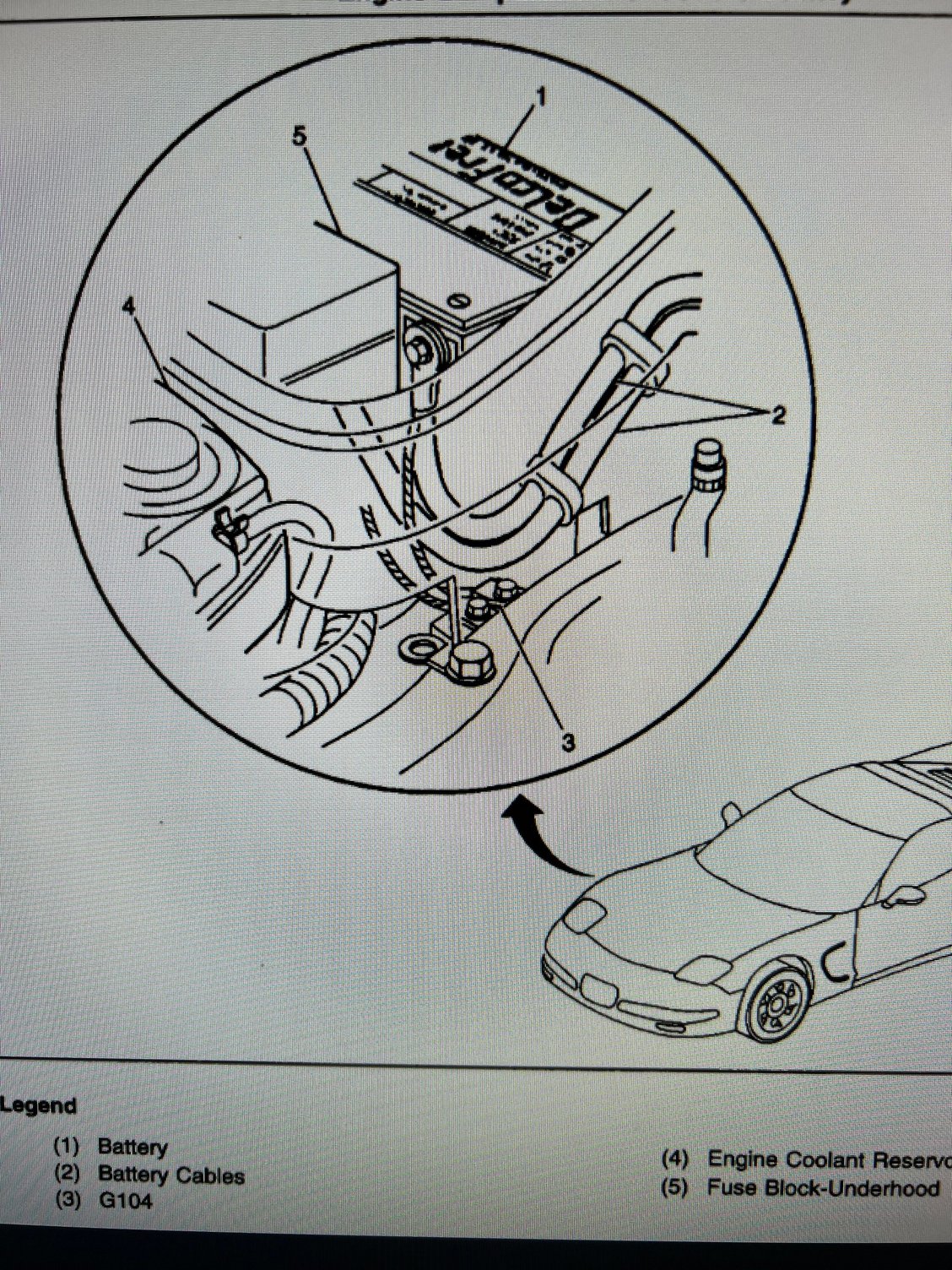

Also check G104 which is a ground for the BCM…near the battery !!

G201. Hazard and wiper motor is working. Others are not in the diagram.
