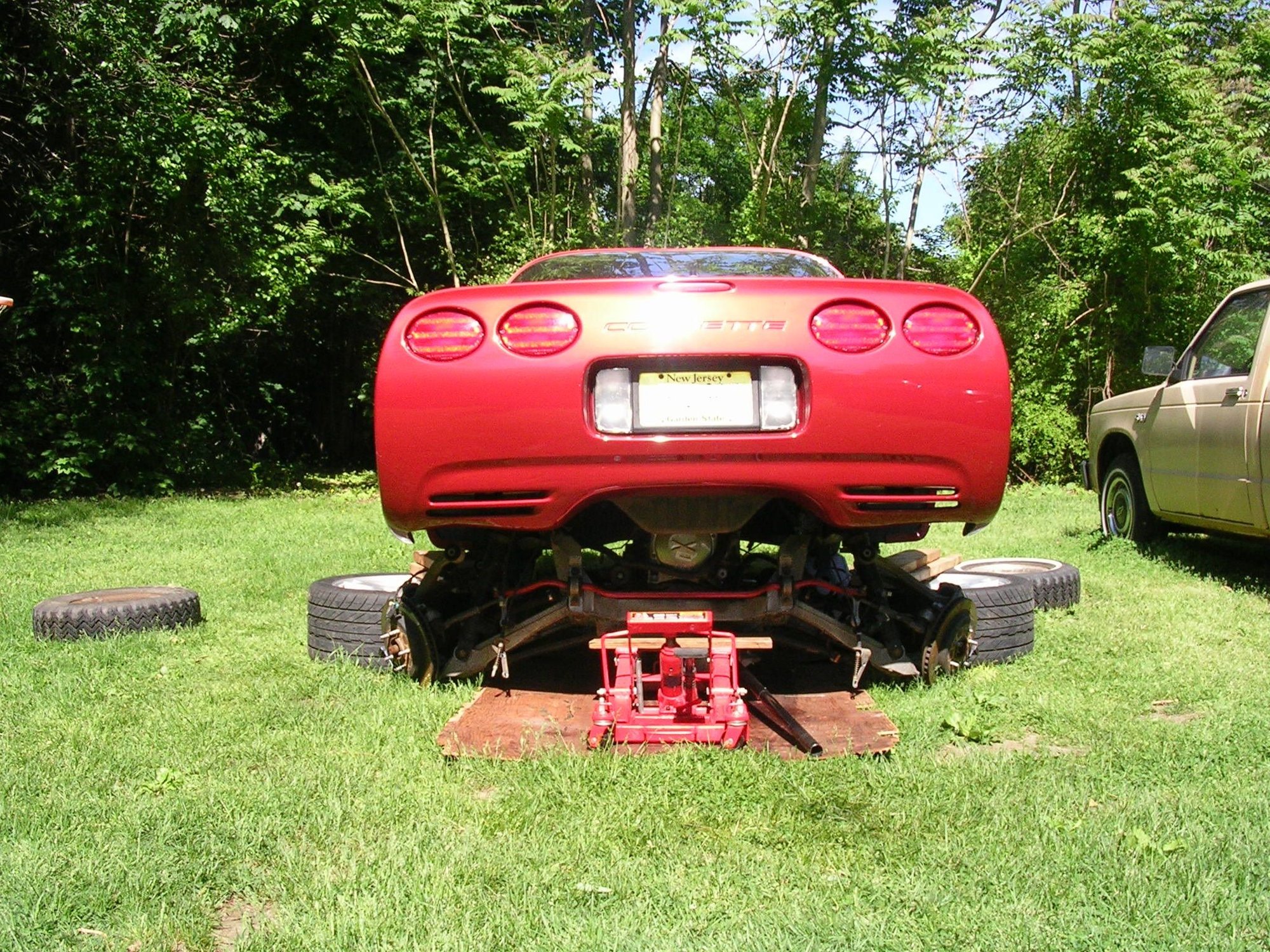

Old Feb 26, 2022 | 11:39 AM
johnson-rod's Avatar
johnson-rod
Joined: Oct 2007
Posts: 2,375
Likes: 426
When the drive train was out...
