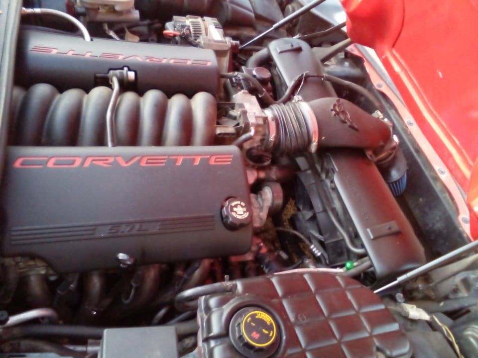

i had asked once before but im about ready to install a catch can in the stock crankcase ventilation line. After installing the air intake filter and pulling air birdge off you can see a puddle on the bottom of the throttle body. Is this from the passenger side valve cover hose that runs to the throttle body or from the two rear valve cover ventilation lines that run to the intake with a pcv valve? Which one do you install catch can on or do you install it on both? I like the one on the tb it keeps pressure from building up and blowing out rear mail seal. I seen some people run two for each line but is there one with 4 ports 2 for entry from both valve cover lines and 2 for exit to the tb and back of intake in 3/8" barb fittings?

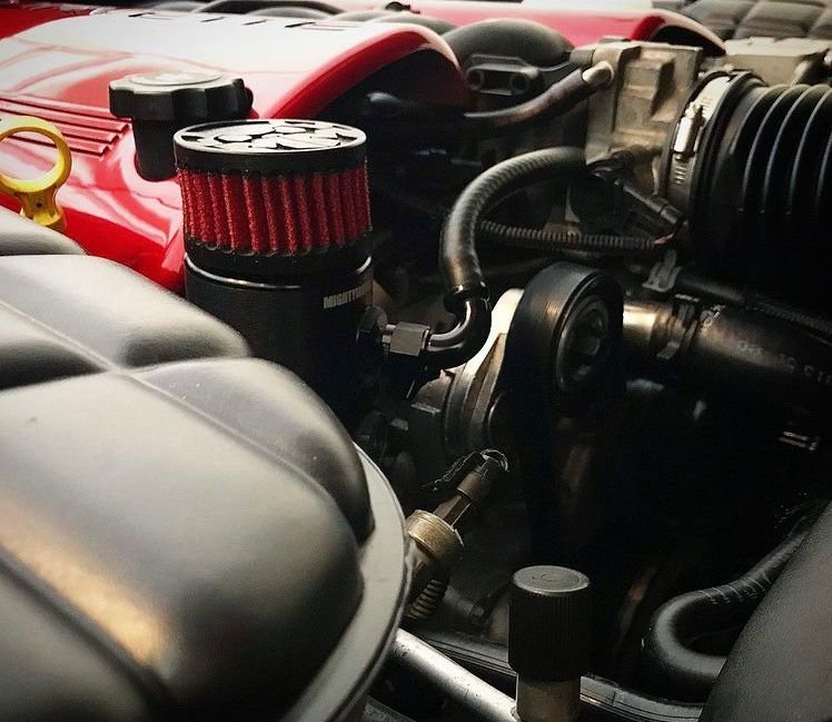

Some of the best engine builders in the business recommend catch cans (katech, rpm, blue print, cordes, etc).
I would recommend might mouse. Excellent product. Excellent results.
install depends on your year. Post a pic of your passenger engine and I can tell you
how to install. It’s very simple.

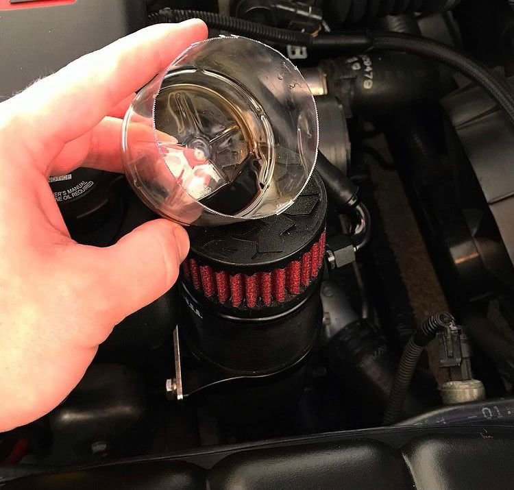

this was my catch after about 50 miles. I’m actually trying to find a new ls6 intake. I can only imagine how much oil sludge is in my intake before I installed this can.
how to install.
Mine is a 99 corvette just like yours doesnt have the 01 or 04 valley cover vent. The crankcase lines are on the back of both valve covers and one on the passenger front. It does cluster the engine bay but yours looks nice. Does this photo help? I was thinking the 20$-30$ amazon catch cans. The amazon catch cans are similar inlet outlet port 3/8" with baffle just run the intake line to inlet port and catch can back to the intake. On amazon some people had mentioned the metal baffles or metal aluminum cans having extra metal burs that could end up getting sucked into the engine. So you leave the passenger front port to throttle body hose alone?

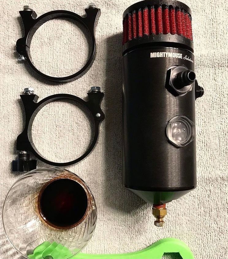

How much is the mighty mouse and about how many miles till it fills up? I read other reviews different cans not catching any oil.
hahahaha. Sorry. I’m going to need to see under that passenger engine cover. Lol.
Just the year alone doesn’t help when all of these cars are so heavily modified.
