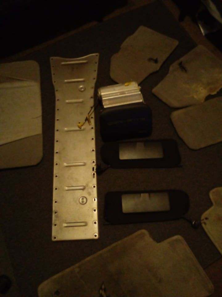

Great probably will get the ebay tunnel plate if i cant afford the elite engineering. Ever since ive had my car its never had the tunnel plate. I found a c5 plate locally for 30$ just to have it does appear to have a ceramic coating or grey type of material on the exhaust side. I got a deal on it with the air bag, heat shield, used sunvisors and grey floor mats. The air bag was 70$ 99-04 are the same black according to mark at vette nuts wanted 95$ and 25$ for heatshield. so luckily i found this this evening. They arent the same as my jetblack interior but will have to do miami corvette wants 190$ shipped for the trunk compartment panels and vettenuts wants 225$. If i ever get that far modding the vehicle ill upgrade heatshields.
