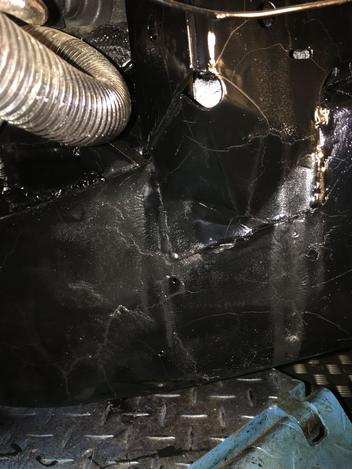

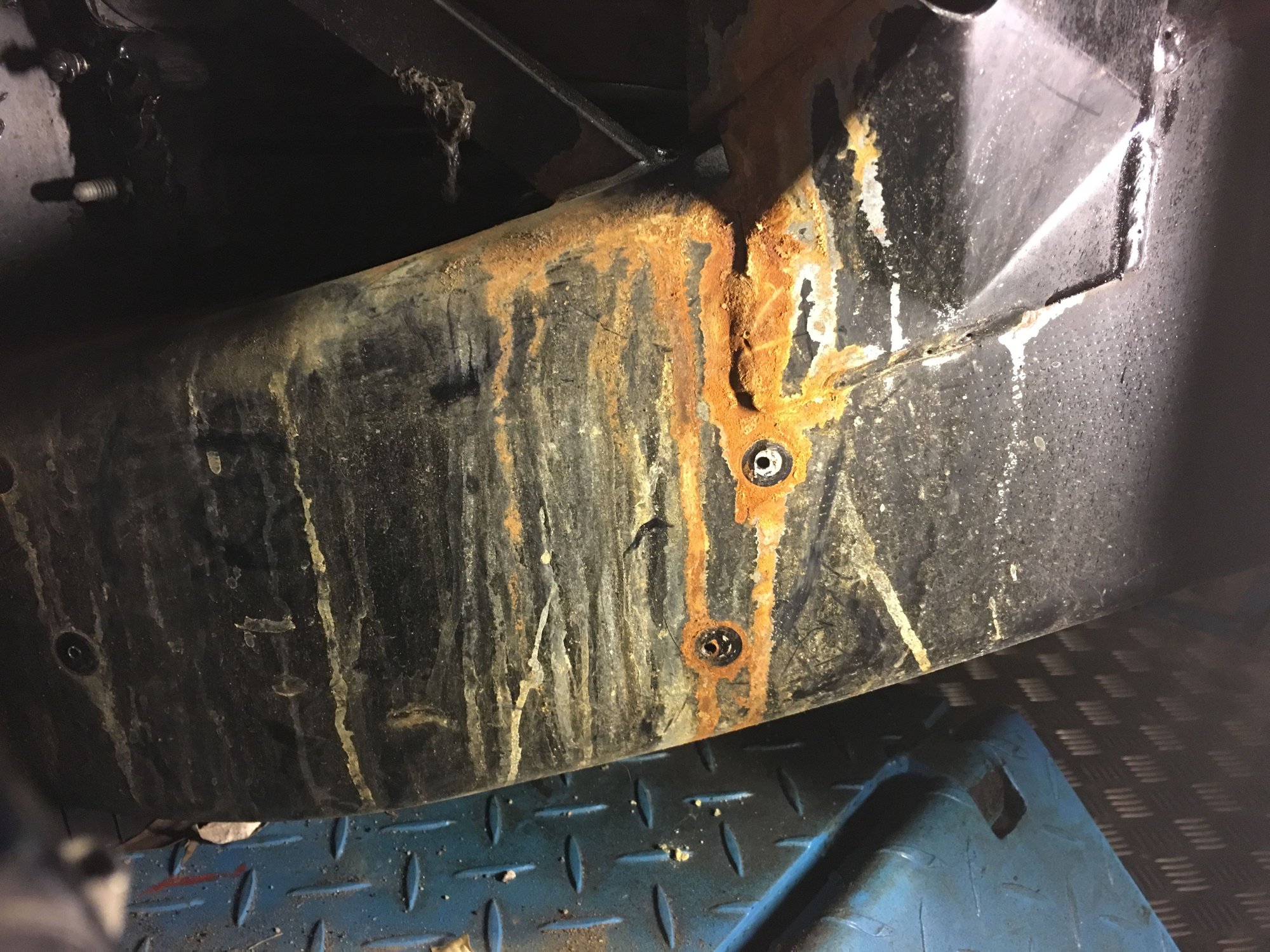

I fully agree to Bill's words .
This pictures show how my car looked like below battery before and after cleaning/painting
