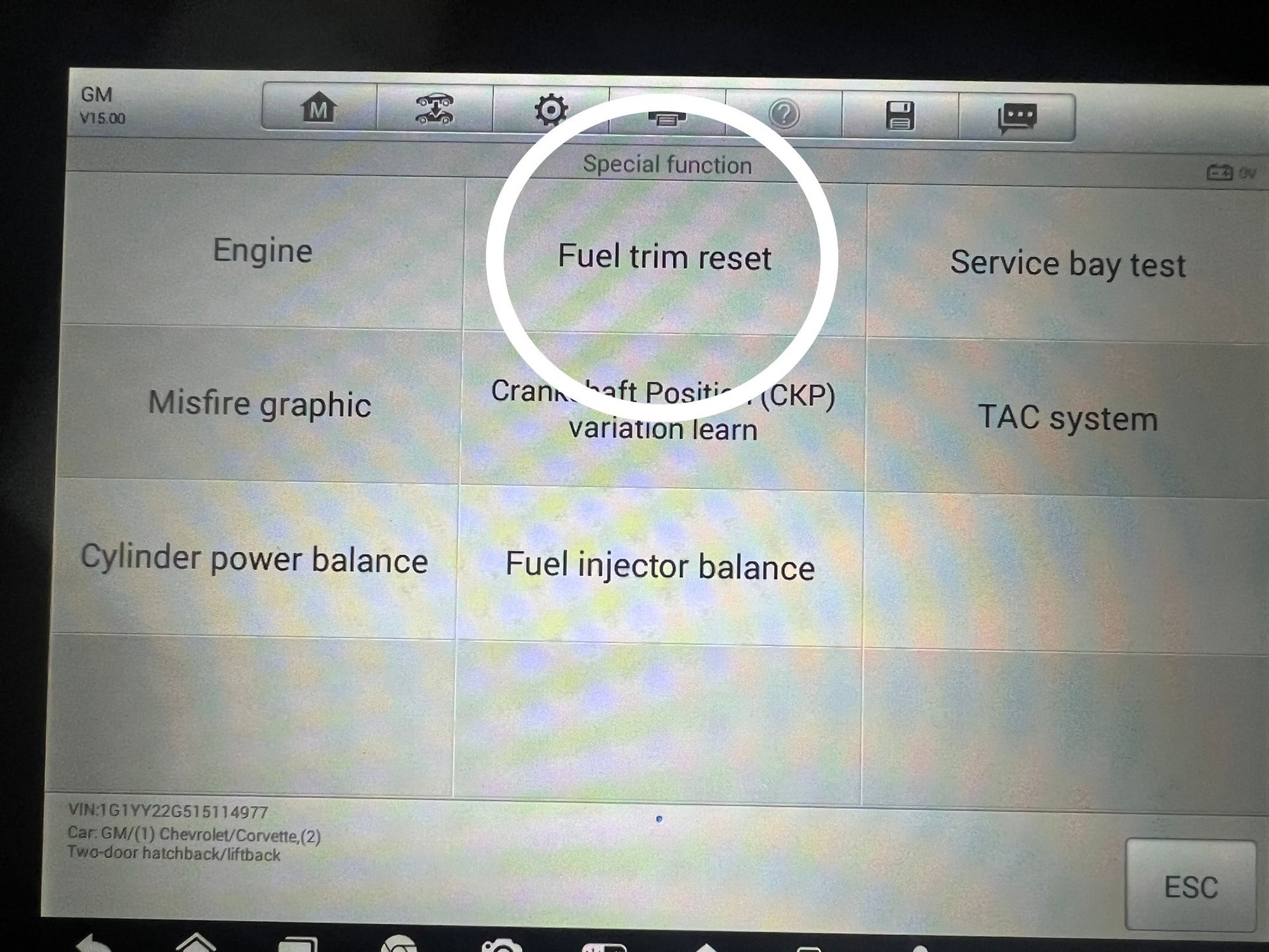

The fuel trims will not reset if a DTC is cleared…if you have a decent scan tool you should have a “fuel trim reset” usually under “special functions”.

If you need to reset the LTFTs just disconnect the battery for a few minutes. After removing the battery cables you can touch the cables together to assure all voltage has been removed from the PCM.
