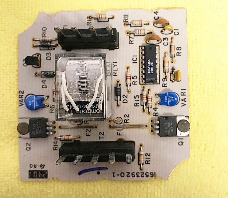

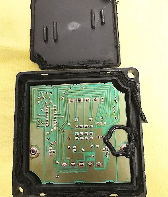

Here are some pictures of the used (but new to me) module I purchased. It didn’t solve my problem but I opened it up. Here are some photos. This module should work fine. I don’t see any water intrusion. Although it does appear someone has been in here before.
does beg the question, if this module works, why was someone digging around in it.

FWIW - That is some level of corrosion on pin-2 of your T2 connector.
