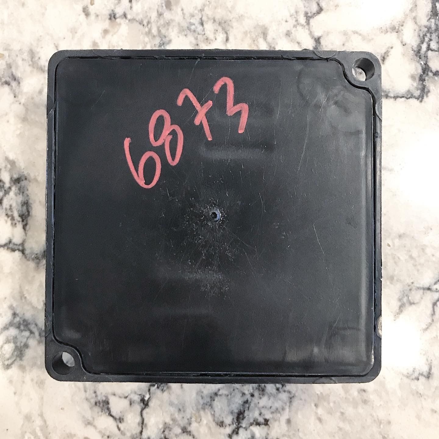

Haven’t seen too many photos of the headlight control module on this forum, so here is one. electrical connectors all look good. No visible water intrusion. No signs of corrosion. Hoping it’s just a bad module.

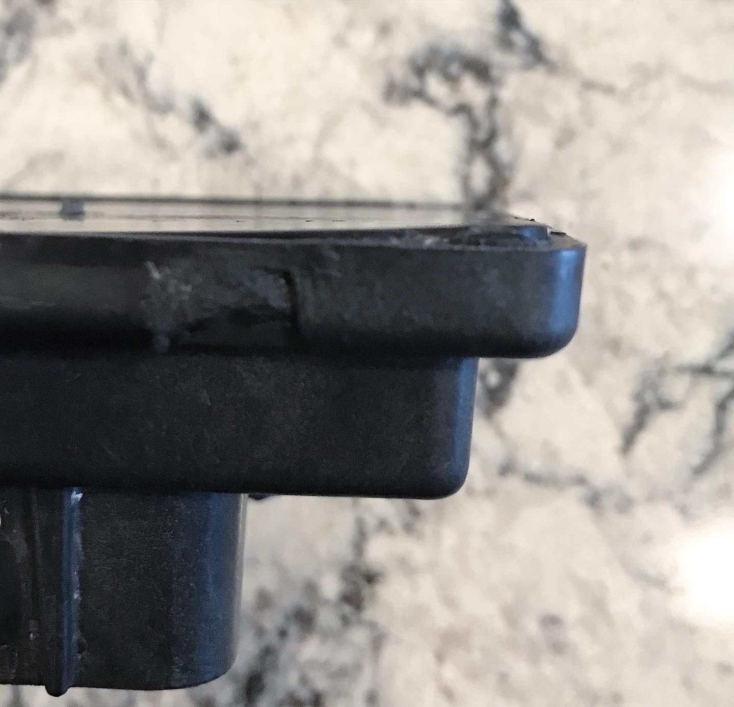

On the back of the module is a sealant that seals the entire module case. It has been well known to shrink and separate from the sides of the case. Thats where the moisture gets in. Pull it off the mounting location and inspect. Please let us know what you find.

The new (used) module came in today. Going to need to be sealed more securely if this winds up fixing my problem.
