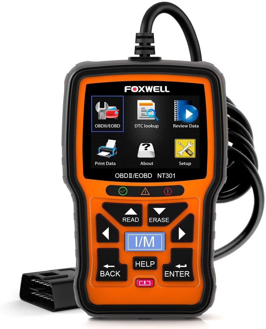

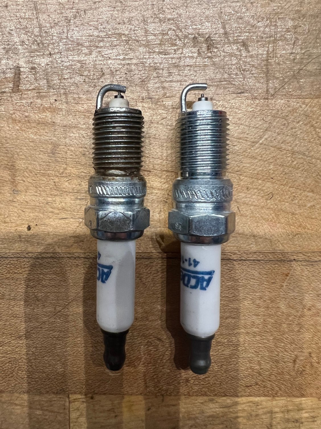

OK. To close out this thread and hopefully pay it forward to other members, I purchased the Foxwell NT301 OBD2 Scanner for around $75 with S&H off Amazon and it worked great. It works for both my C5 and my C7Z and it also works to pull codes from my wife's 2021 Mazda CX-9 SUV.
By using the scanner, I was able to confirm that the DIC code 10 PCM P0300 was sub-identified as a Cylinder #5 misfire. (So happy it wasn't PITA #7).
I went in and removed the spark plug wire and plug from #5 and it was obvious that the original replacement AC Delco 41-162 Iridium spark tip was damaged during my initial installation. The Iridium plugs are pre-gapped so you can see the difference in the damaged plug on the left and the new undamaged plug on the right. I remember dropping it during installation, so the misfire makes sense.
Overall, not a bad investment to the tool box considering a dealership would have charged me at least $80 for the diagnostics, service and new plug.

I bought the NT301 after reading your post but found that it would not communicate with my 2004 Corvette. I, too, had the P0300 code and hoped to isolate the particular cylinder(s) throwing the code.
The scanner worked fine on my 2017 Santa Fe and 2009 Dodge RAM, connecting almost instantly with those cars, but would never connect to the Corvette!
Before using the scanner for the first time I updated the software to version 2.40.002
Is that the same version you were running?
Before I return it to Amazon, can you --or anyone else -- shed light on what went wrong?

My $12 Ebay scanner works fine on the Corvette -- just doesn't have the granularity I need...
Would that be affected by cig lighter fuse?

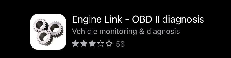

I use this obd2 reader on all my cars to check/clear codes as needed
Amazon Amazon
Then I use the "engine link" app on my phone to work the reader via Bluetooth

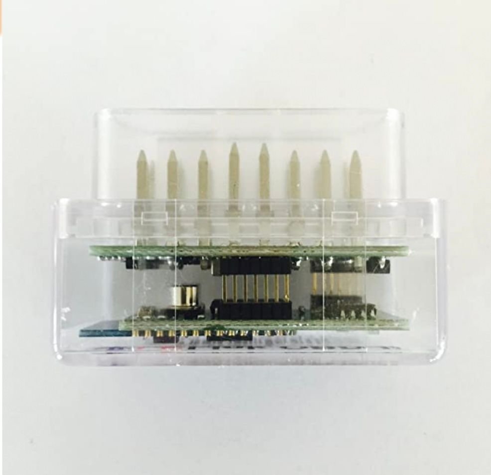

Default Beware: Virus/spyware install from China on LElink
https://www.amazon.com/gp/product/B0...?ie=UTF8&psc=1
Found this in the Amazon review. Old fashioned cabled OBD readers are still safest. Not fond with anything Bluetooth that requires app downloads. See review below:
Viruses and deceptive sales practices
Reviewed in the United States 🇺🇸 on April 13, 2015
I'm not surprised to see that this item was pulled from Amazon.
1. It comes with a CD that is loaded with viruses. Just for fun I spun up a virtual machine and let them go rampant on a firewalled isolated network to see what would happen. The viruses load a kernel module that hides their processes, then they create a text file with any personal information they can find on your computer, and attempt to connect to a server in China to upload the data over a FTP session tunneled through SSH.
2. The device itself is was sold using deceptive sales practices. It only supports three cars, and it only supports two of those partially.
