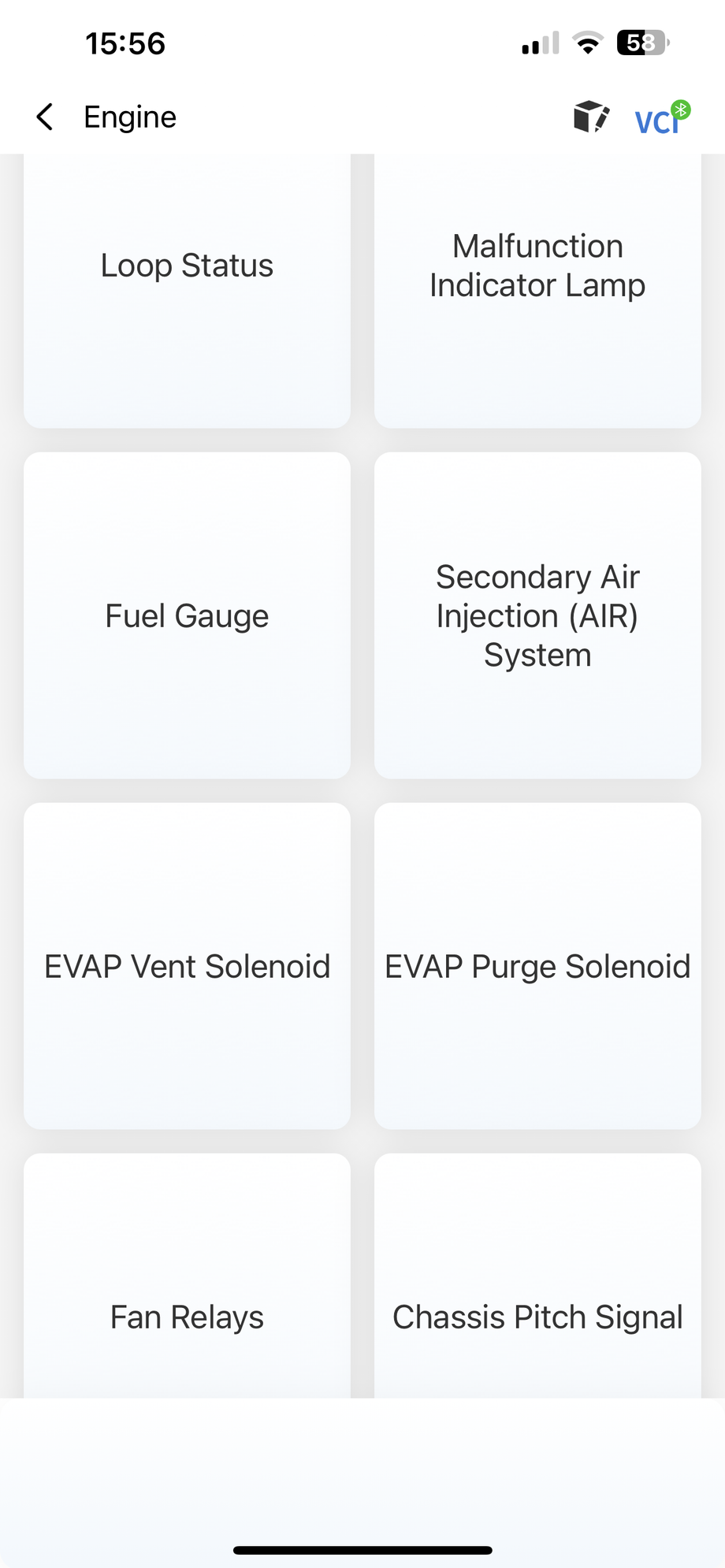

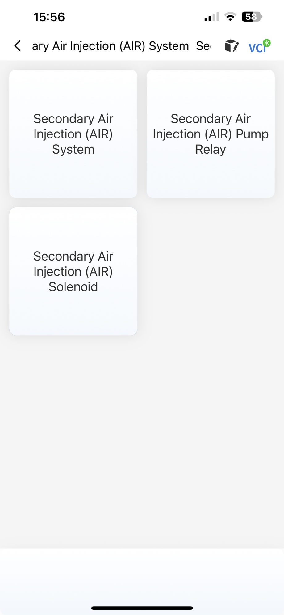

In my opinion checking out codes are only one aspect of troubleshooting cars. To be able to view sensor signals are also importent to verify diifferent sensors .

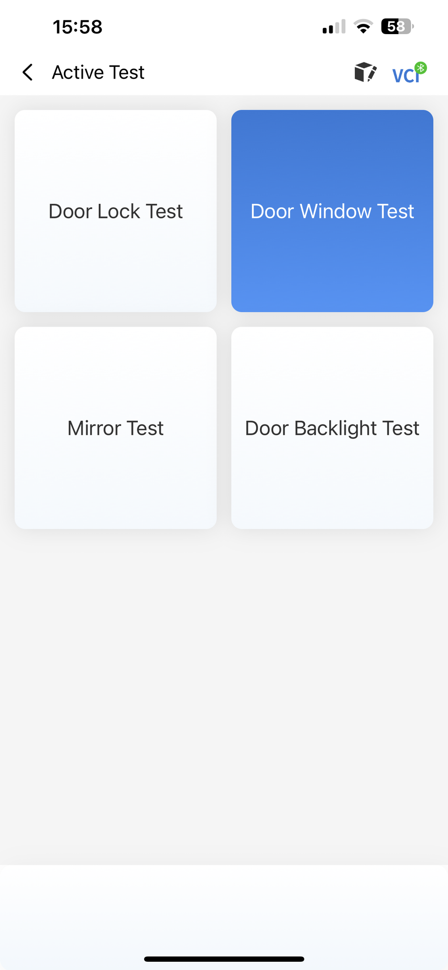

In addition to have bidirectional to is very nice . If I window does not go up , you can use the scan tool (like Tech2) to force doormodule to drive the windows up and then troubleshoot/measure the relays /wires .
You can also verify if the doorbutton for window up works does operate corret by viewing input signals on the scanner .
Having a bi-directional scanner is very time efficient during troubleshooting comepared to only using a codereader .
In my own experience if you you don't have a laptop a Tech2scanner is a good way to go if you have a C5 /C6 .
If you have a laptop win10/win11 a VCX NANO with the Tech2win program and a 9 feet USB cable is a good way to go .
You have to download some software and instal it but youtube show you how .
I prefer Tech2win menu on a 13/15" laptopscreen over the small (8"?) screen of the Tech2scanner
I have a SnapOnUltra Edge and Autel MK908P scanner in addition but I mostly use Tech2win with the VCX NANO when I service/troubleshoot C5's .

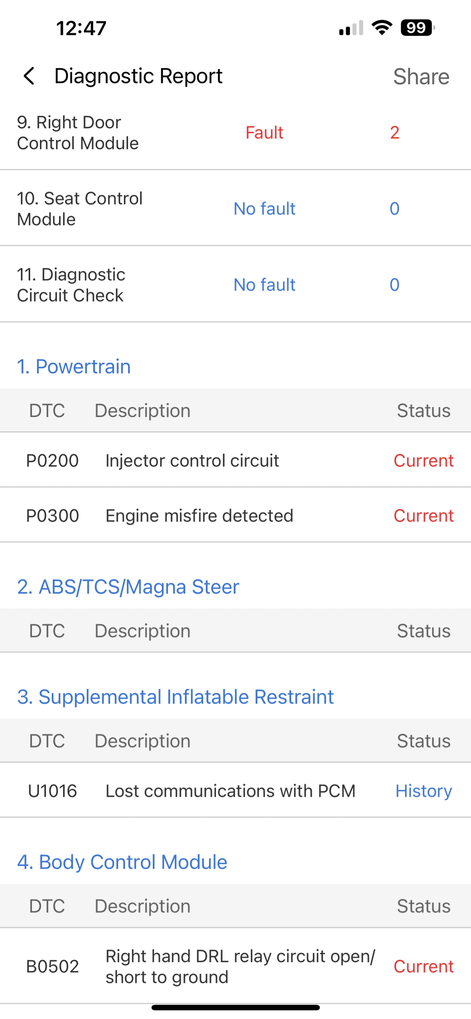

Just recently I bought the TOPDON Topscan USB dongle using blooth to my Iphone . It has can be used against a lot of car brands , has bi directional capabilities ,view live data and create a detalied scanreport for the car
like this :

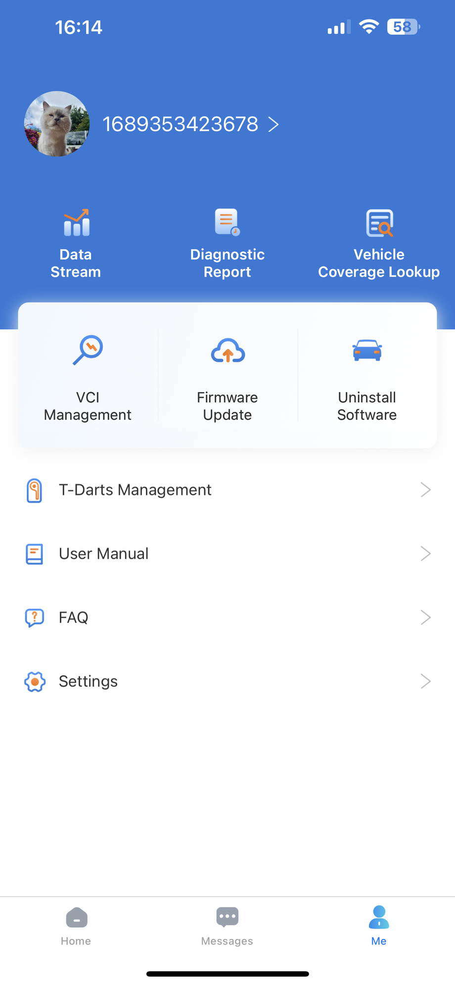

I'm glad you liked it and it seems to be very nice low priced OBD2 Bluetooth dongle with good quality .
I you use the attached usb cable to a phone charger you can power it inside your and connect to your your phone using the buetooth and download manufature (brand) software the dongle by means of home wireless network instead of the mobile nettwork
If you see my last screendump and press ME (lower right corner) you can access Diagnostic reports and Data stream reports(recorded live data) on your phone
