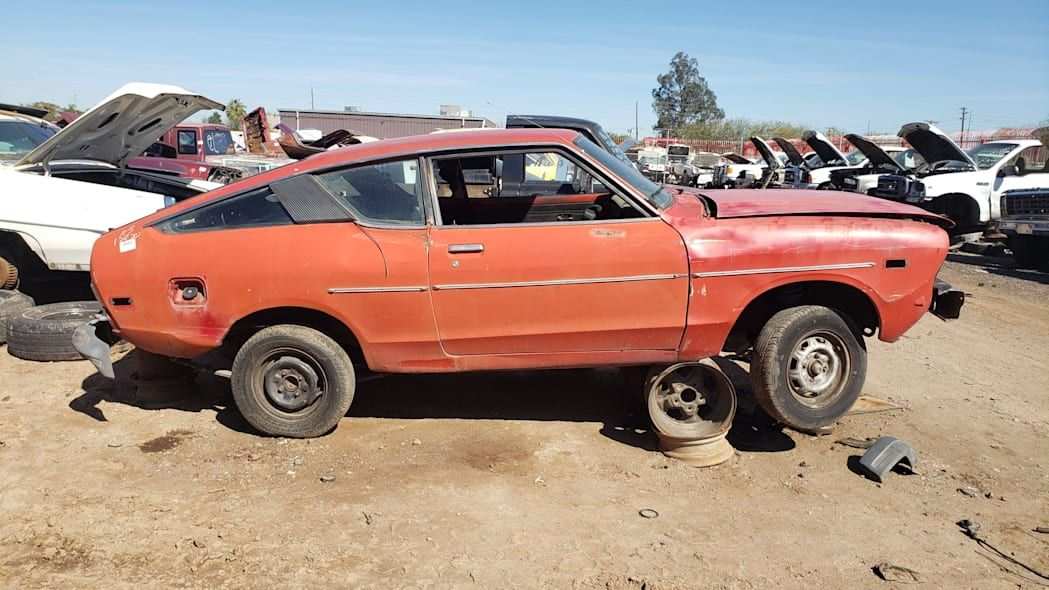

Originally Posted by zztopo
To prove my innocence Napoleon dork boy. And the court date has been exonerated. My tongue is sticking out at you. Go get in your Datsun B210 and try to get on the Interstate.

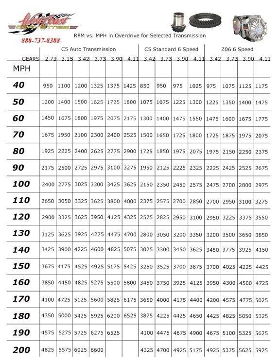

Joe used to frequent LS1 Tech forum back in the day.
You may very well have a steeper gearset in it already. Although it's likely something the seller would have called out. You can figure that out pretty easily though with the below chart and some cruising time in the car.

Wow, thank you!
