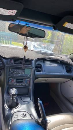

I have had a lot of fun with my '77 Restomod but I have been feeling the itch for something different. So last Thursday my car went up on CL, FB, and Ebay and already someone has made a tempting offer. I should be able to get around $20K for it and that will be my budget for the new car. Most C6s are in the high $20K range so I'm looking at C5s. One that caught my eye on CL has 77K miles and here is a photo of the console, does this car have the mag suspension? The description in the ad does not mention that. If so what are the prevailing thoughts on buying a used Vette with 77K miles and mag suspension, an expensive risk?

It has the adjustable suspension, note the dial near the E-brake lever. Normal, Touring, and Sport. The button to the left of the dial is for traction control. Ask them if they still function and are the original ones. My ‘98 still has the original shocks, aren’t leaking, and still work.

Long story short. There are 2 systems. F45 is selective ride (selective shock valving) F55 is magnetic (magnetic shock fluid). F45 has 3 settings, F55 has only 2. The change over was for 2003. Both work well, but the F55 shocks will seep fluid and it's normal. A lot of owners have replaced F55 shocks for seeps and not leaks and I think it's been given a bad reputation. I would be buying all of the seeping F55 shocks I could right now.
Worst case you buy new C6Z06 shocks and disable the system.
​​​​​​I have F45 and also have 77k miles on my car. Still working like new.
