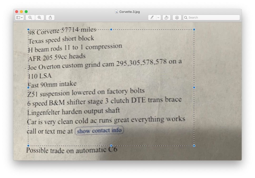

Old Jun 2, 2022 | 10:50 AM
MetalMan2's Avatar
MetalMan2
Joined: Dec 2018
Posts: 2,655
Likes: 1,386
From: Orange County, CA
Yeah "stage 3 clutch" is pretty vague. My guess would be an uneven flywheel surface. Sounds like no matter what clutch is in there, the only solution will be clutch replacement...
If you want to at least assess the clutch situation, you can remove the midpipes fairly easily, and then drop the clutch inspection cover. This will give you a good look at the clutch and slave cylinder. (I'm assuming there aren't long tube headers in the way since they're not listed on the mods sheet)

Yeah, that fact sheet wasn't complete from he previous owner. It does have long tube headers. Time to take it to the shop? An clutch ideas that won't break the bank? I'm at 475 rwhp and I want to add a 100 wetshot.

Oh ok, thanks, he knows no specifics other than it was a 3 stage clutch. I am the 3rd owner of this C5.
