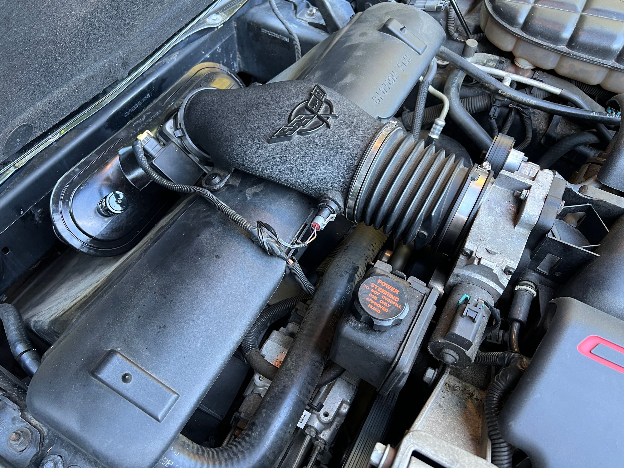

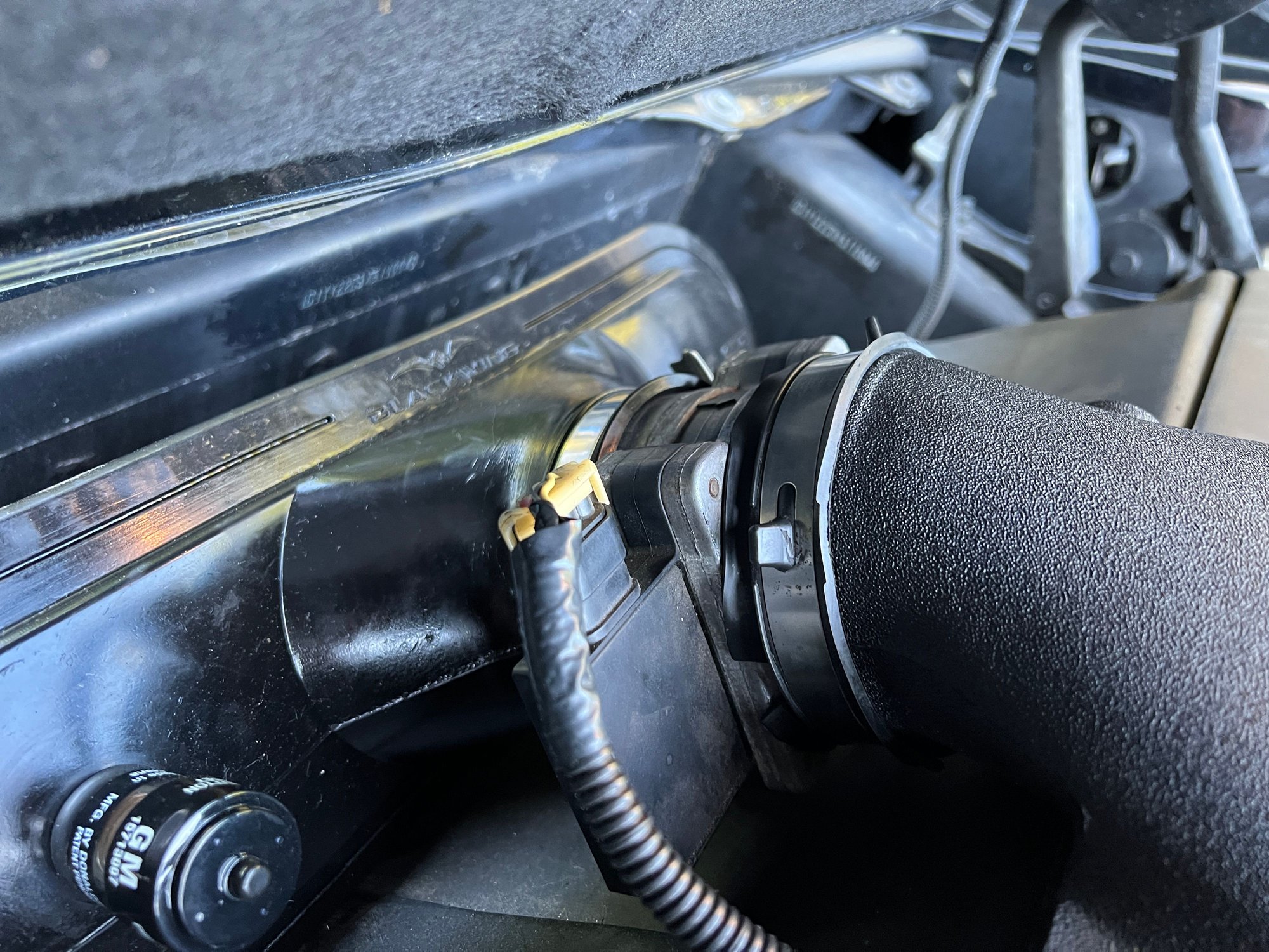

I just took the system apart and cleaned the MAF since I had the cleaner. MAF and IAF connectors reseated.
Attaching some pics of current setup.
Car was fine all day yesterday and this AM - CEL only appeared when I pulled into the drive way.

I believe the 0113 is a IAT signal circuit "high' which means the 5 volt signal wire (tan wire) isn't getting pulled to ground through the sensor and the ground is being supplied by the purple wire...with key on see if you have 5 volts at the tan signal wire first...if good now connect a 12 volt test light to battery positive...probe the purple wire and see if the test light illuminates which indicates you have a good ground...the ground is a PCM ground.

From post #4 the picture shows what could be a crack in the air bridge bellows just before the throttle body. Check that- it could be un metered air coming in.

Shop just called, bad wire in the IAT pigtail; they are replacing and car will be ready today.
