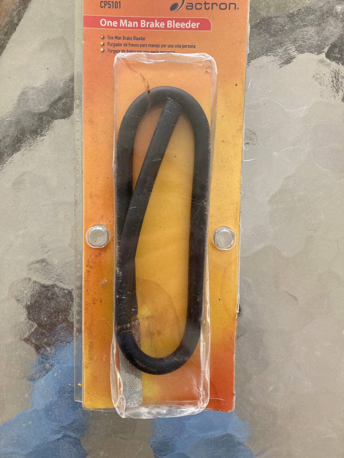

Thanks for all the advice. I found this gizmo in one of my tool boxes. Don’t remember where or why I got it. Looks like it slips over bleeder valve and has a check valve at the end. Think I will give it a try.
To Brake fluid change question
