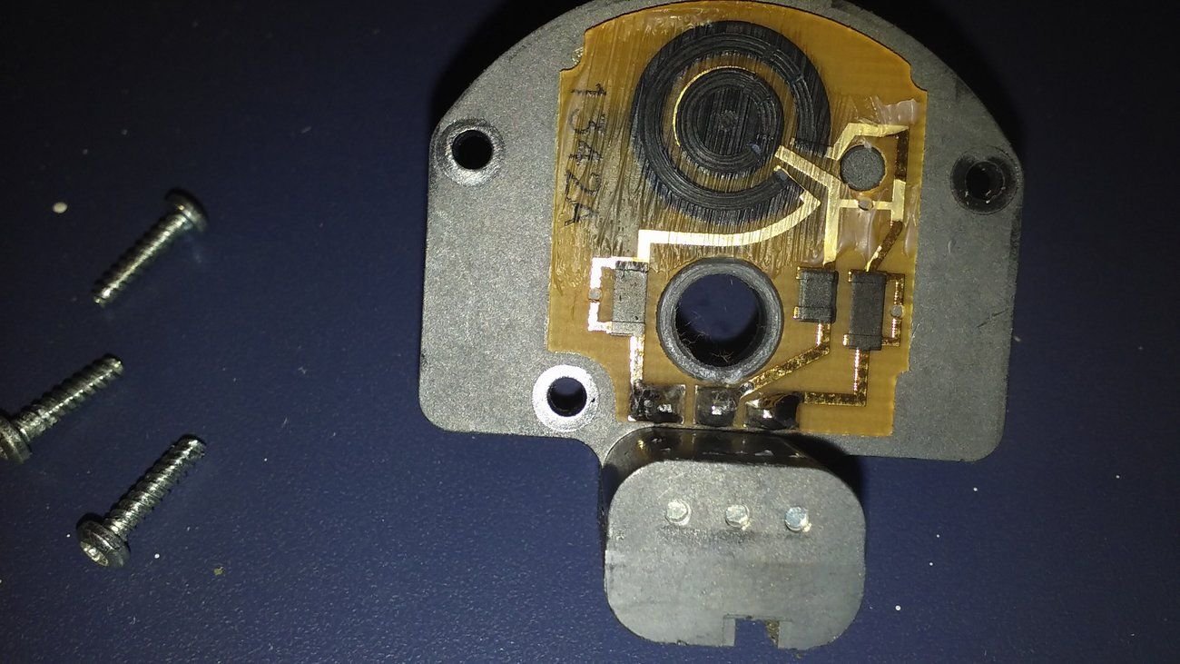

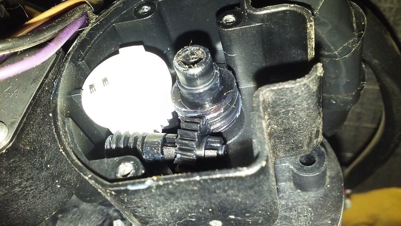

The seat issue could be the seat switch gone bad or the seat position sensor contacts in the back of the seat motor are gunked up and not making good contact. Those contacts can be disassembled and cleaned.
another approach to try first would be to run the seat back and forth full travel several time and see if the seat operation improves. If it does improve, that points to the seat position sensor contacts being gunked up.
Rather than unplug and plug in the seat connectors for testing, it may be more convenient to pull the respective seat circuit breaker in the passenger footwell. If you do that the telescoping steering column still works although the seat is disabled.

Here is a post I made quite some time ago on seat issues. Also check the imbedded link in that post
https://www.corvetteforum.com/forums...n-mystery.html
https://www.corvetteforum.com/forums...ery-drain.html
