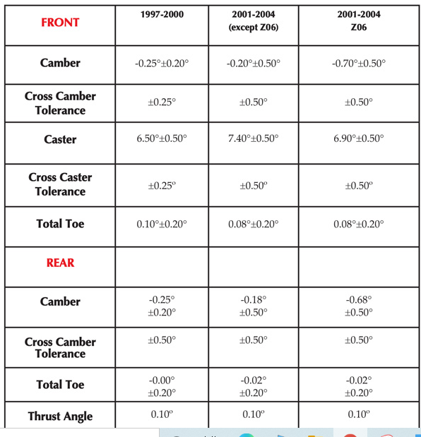

Likes: 138
From: Florida
St. Jude Donor '09
Old Jun 27, 2022 | 12:18 PM
Kubs's Avatar
Kubs
Joined: Oct 2007
Posts: 9,700
Likes: 3,469
From: Akron Ohio
2024 C5 of the Year Winner - Modified
2023 C5 of the Year Finalist - Modified
St. Jude Donor '09-'10-'11
Originally Posted by ipuig
These look like the factory alignment settings which would not be good for autocross.
Originally Posted by tpr60
Front camber 2.5 deg neg. caster 7.5 pos. Toe out 1/32 Rear toe in 1/32 each side 1.5 neg. camber. Tires, 200 tw non run flat.
This is a pretty typical setup. Basically max camber front, and toe should be between 0 and 1/16 total toe out. Rear -1.5° to -1.8° camber, but I would go 1/8-1/4 total toe in. More rear toe helps keep the rear from being too loose.

[QUOTE=Kubs;1605330594]These look like the factory alignment settings which would not be good for autocross.
Not good for you perhaps.

Not good if you want to be fast and have the outside shoulder of the tire survive...
