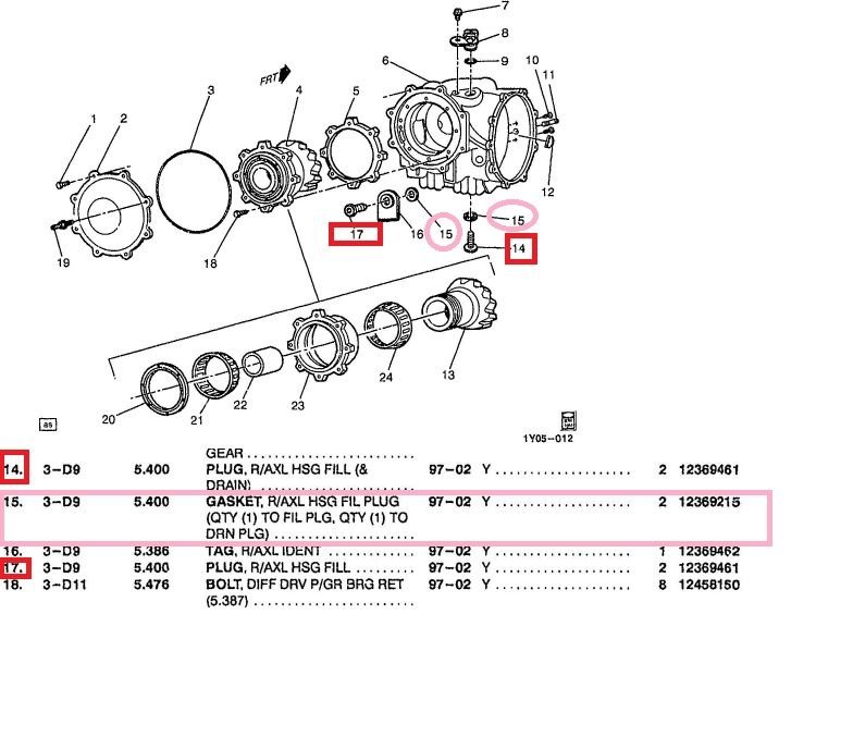

It is easy to remove the complete vent and install a new one ? It is easy to put the new one back ? I don't want to connect the hose to the vent I just want to replace the whole vent any idea ?
Another question is are the drain and the fill plug are the same or different thread ?
Please update your profile with the model year car you have to include wether it's an auto or manual trans as there ar difference between all model years...
For the 1997 thru 2002, the fill and drain plugs are the same item/part number.
The differential vent is pressed in to the case, very difficult to remove while the differential is installed in the car...after looking at your photo, just make sure the cap on the top of the vent is loose and rattles but you can't remove the cap by hand.
Cheers,
Goose
Thanks. I update the profile . So the top vent it's loose and you telling me it's better to leave it alone . ? My car 2003 automatic so still we don't know if it's the plugs are the same or no for differential ?
Thanks for updating your profile as this will be helpful in the future.
So the top vent it's loose and you telling me it's better to leave it alone>> Yes, if the top cap is loose, it is normal, leave it alone.
My car 2003 automatic so still we don't know if it's the plugs are the same or no for differential>> for your 2003, the differntial fill and drain plugs are the same.

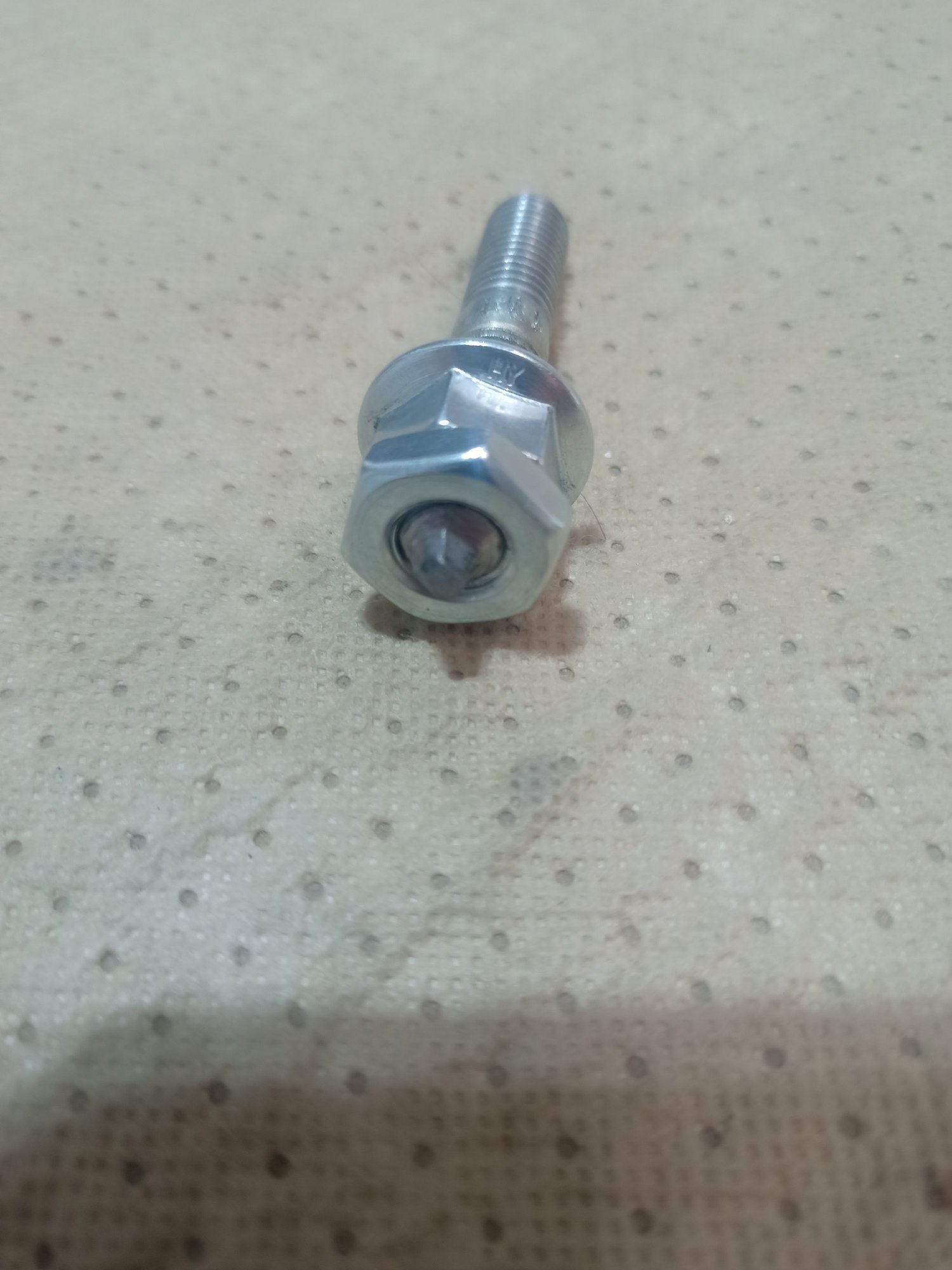

Is there any aftermarket stud that will be same OEM ? It's going to be take forever to order the OEM stud from GM

Is that okay to use the bolt instead to use the stud ? The stud discontinue and look like it's too hard to get it lam thinking to use bolts any idea ?
What the stud size ?

Originally Posted by Smoken1
Parts catalog does not say
Finally. I fixed the problem. Does anyone you know what's the torque for the stud ?

I believe it is 37 ft lbs.
https://www.corvetteforum.com/forums...rque-spec.html
https://www.corvetteforum.com/forums...pec-sheet.html
A friend and I resealed both of the side covers yesterday using the 2 videos linked about. The stud came out with 2 nuts on it. We reinstalled the same stud.
NO! ! ! ! Off hand I think it's 18#. 37# is for the 2 halves of the diff carrier inside the case. You WILL strip the side cover bolts at 37#.
18 for side
37 for the stud
