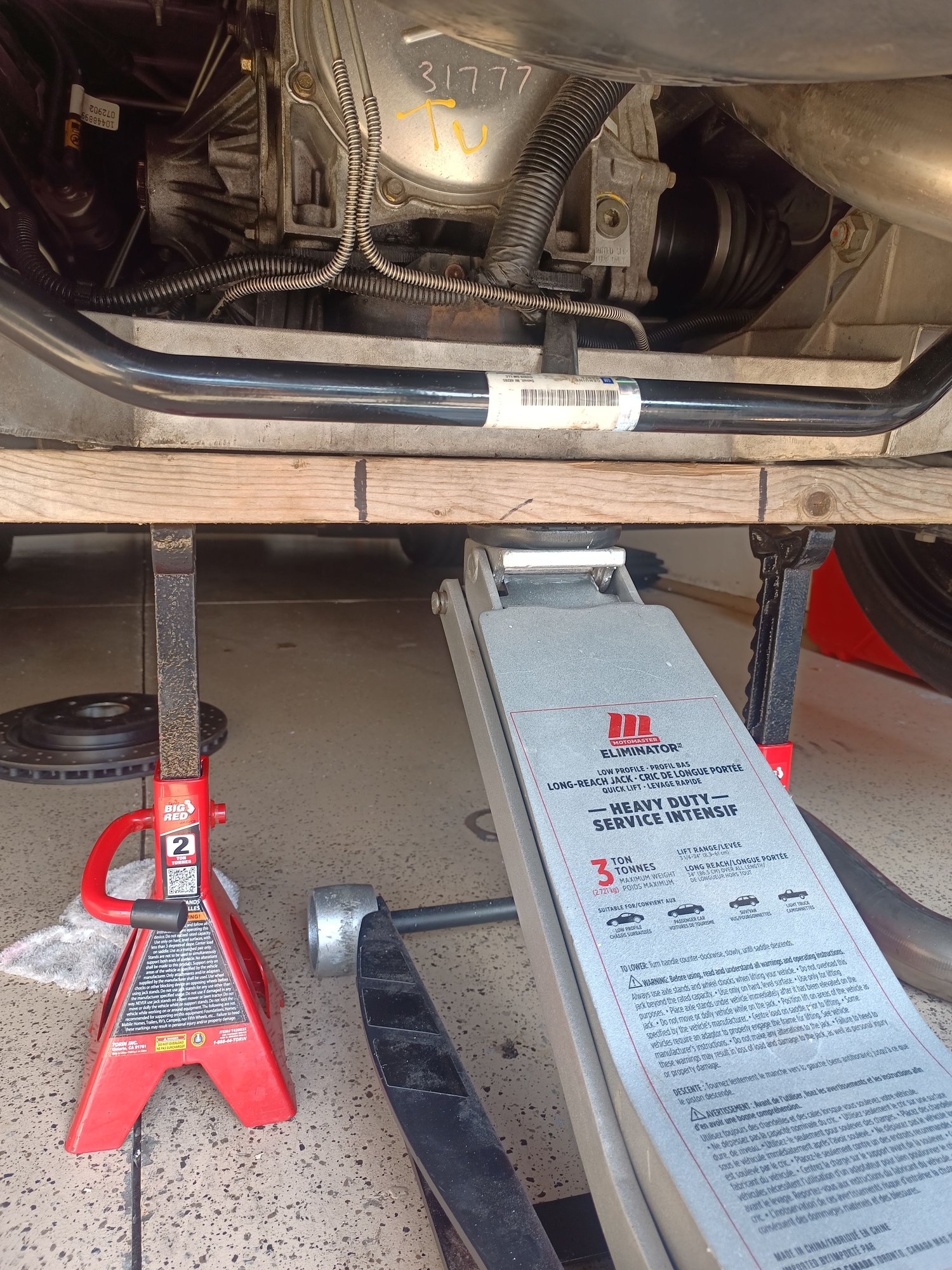

I'm going to fix the leak (driver side cover) differential I know there is stud need to take off but my question is I jack the car from (crossmember) under differential is that will be affect the stud ? I mean it's going to apply pressure to the stud or change the balance or it's wrong to jack the car from there ? I need to make sure before I took the stud off ? I don't know if I am supposed to jack the car from there or from the side ?
This is how I jack the car
Do I am ready to take the stud off yes or no?
I don't want to take the stud off then I can't put it back because the way I jack the car ...?

You're not getting the diff out without dropping that cradle. You need to move the rear jackstands to under the frame rails are the factory tie down points. Unless you're pulling that side cover with the diff in the car. Remember, there's a rubber mount between the cradle and any tension on the driveline so yank that stud, the other 4 fasteners will keep everything from shifting.

. So it's okay to take that stud off with the way l put the jack ? lam only going to take off the driver side cover ...even that l can't move the jack now because l took off the CV axle already

..lam just going to take off the driver side cover so do l can take off the stud and keep that jack same position ?
Yes you can remove that stud. It's 1 of 5 fasteners holding the diff to the transmission.

Thank you very much I really worry about that
​​​​​​now I can remove the stud 👍

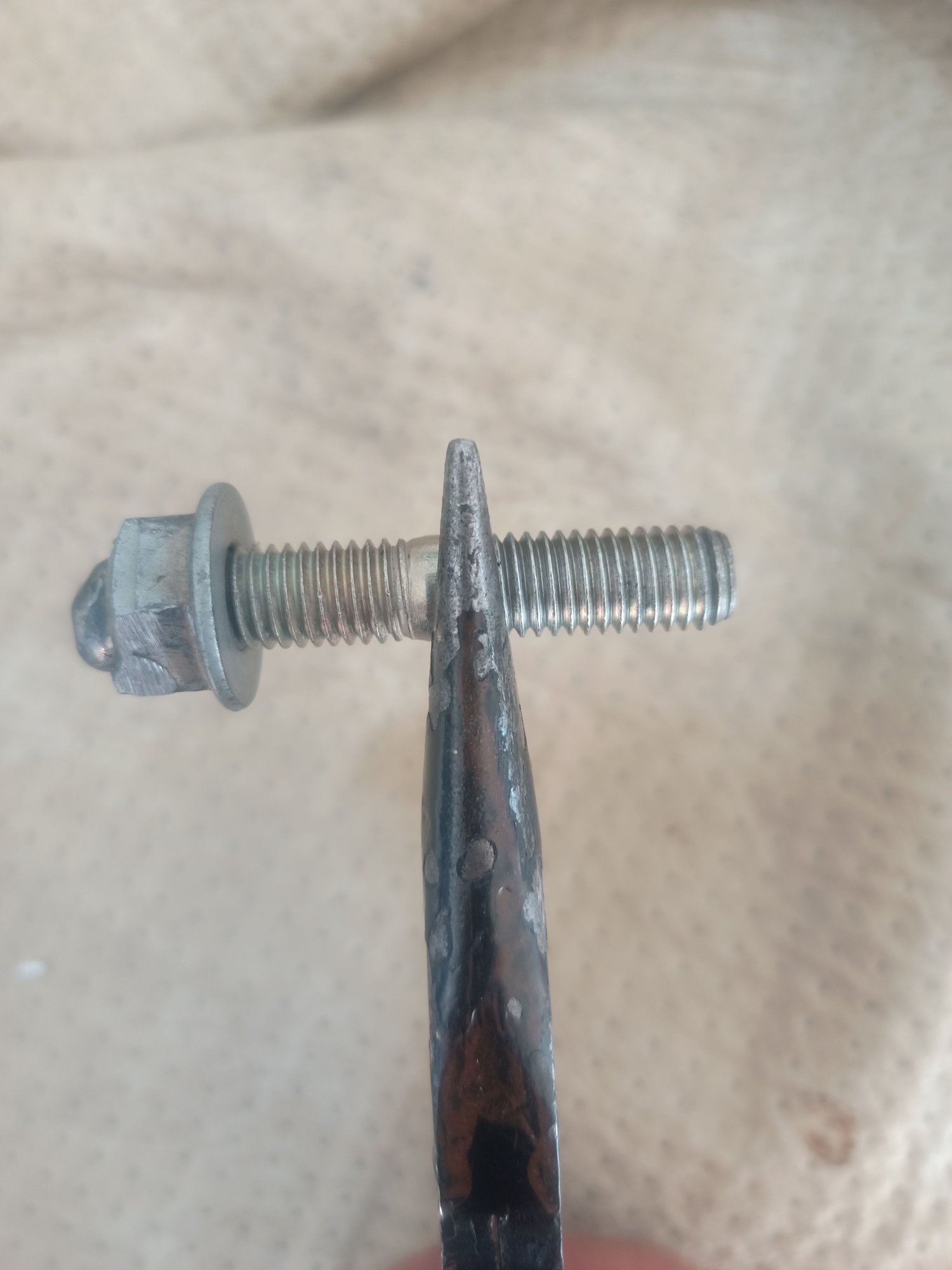

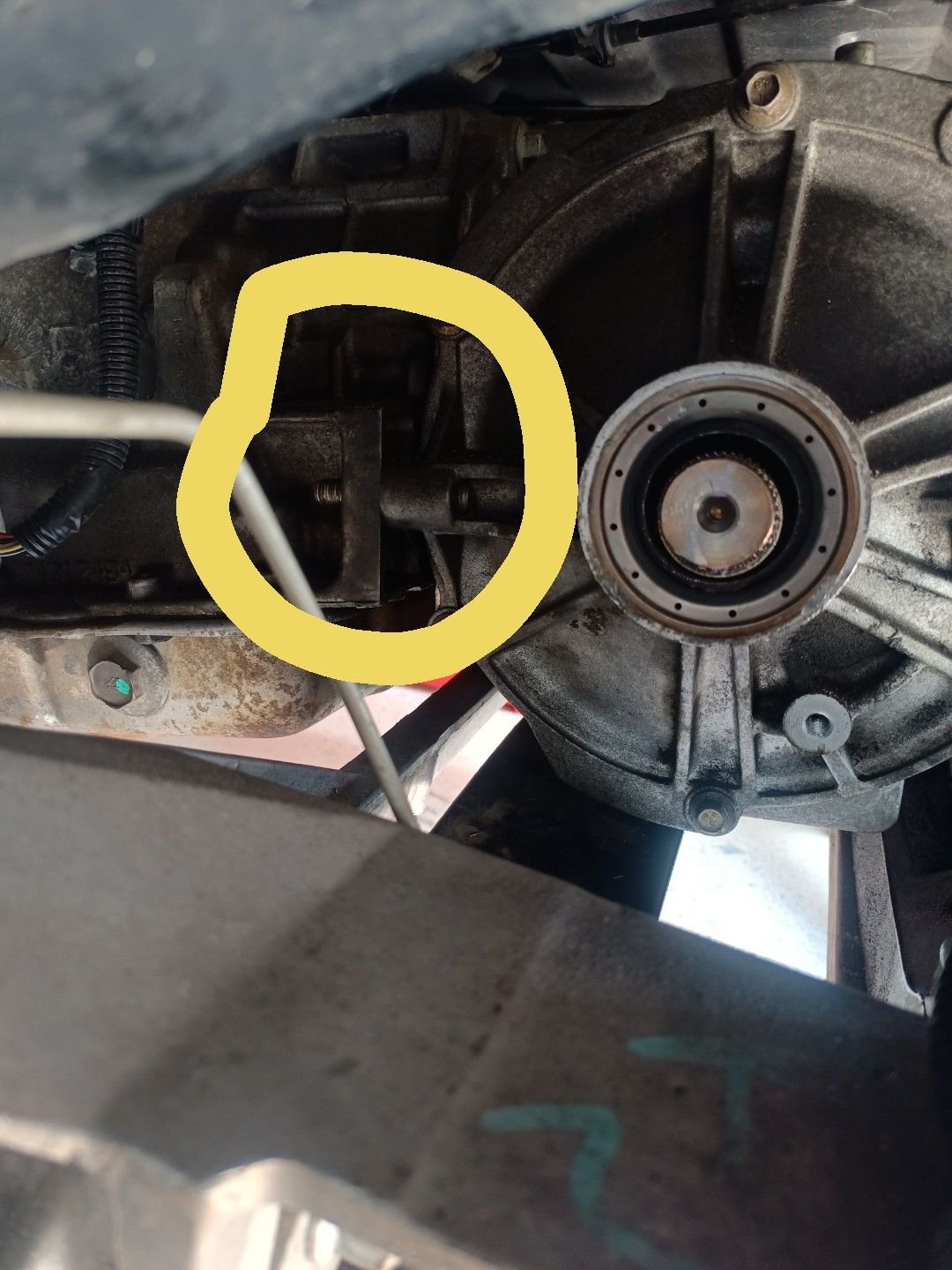

I can't take the stud out there's no space and impossible to find the net that will be work and fit with the stud so I end up to weld the net to the stud and this time they come off easy .what you think guys do l can use the stud again or no ?

If you jam 2 nuts together you can then spin the stud out as well. Grind the weld off and see what's left of the stud.

Believing men the mechanic guy he's my friend he come from the shop to my home to try to take it out the stud it's only enough for the OEM nut l took it out I can't find any two-nut thinner to go together there I cut two nuts the both to make it fit there no luck they get spin together and no space even for the winch to hold it ..the nut inside start to spin destroyed the thread so doesn't work .. once l weld the nut they come off very easy. So ldon't know if l can add a washer to same stud to make it work
Is there any aftermarket stud to replace the OEM ?
