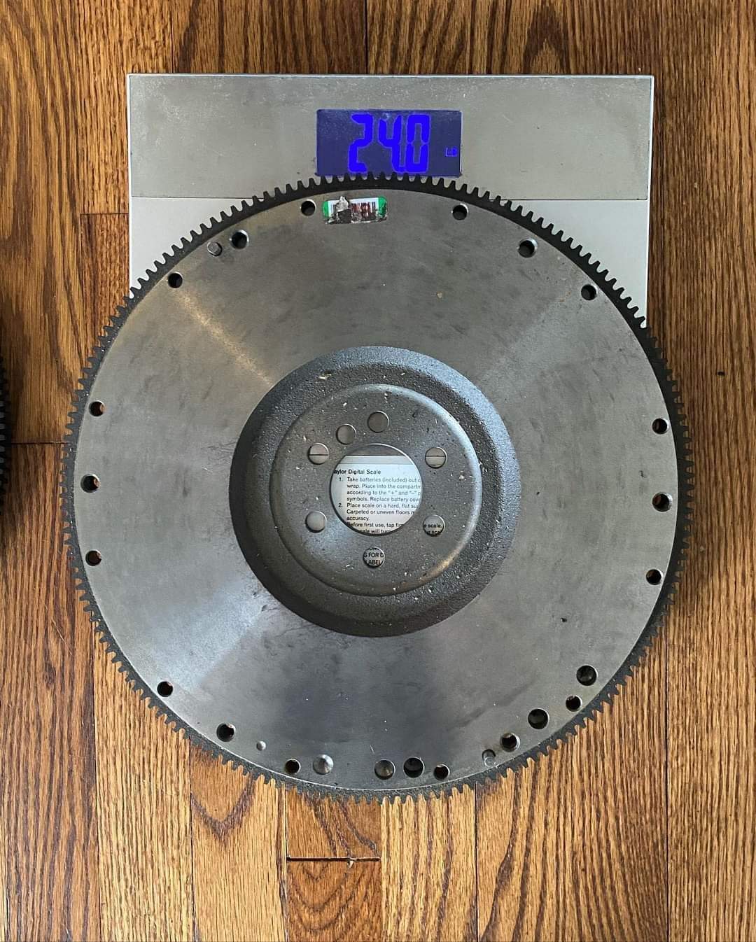

24lbs for an LS6 flywheel sounds correct. I think my Fidanza came in around 10-12lb. I remember it being around a 14lb decrease from stock.
For me the Fidanza (198571) I have was the opposite of above. At about 13.7 lbs in weight. So about 10lbs savings over the original LS6 and 16 lbs over the current LS "OEM" clutch flywheel referred to as the LS7 clutch.
Weight of the Fidanza directly from their site =13.7 lbs
https://www.fidanza.com/products/fid...eable-friction
VERY noticeable weight savings in the revs over either OEM flywheel. Changes driving characteristics significantly.

Maybe thats where the 14 came from. Still a good improvement.
I just looked back through my photos. The Fidanza was 12.6lb. Stock clutch/flywheel assembly was 49.2lb vs the Fidanza flywheel Luk combination of 37.0lb.

More info. According to SDPC, the steel LS7 flywheel is 26lbs, and they offer a compatible aluminum wheel at 16lbs. Perhaps the other reference included shipping weight…?
In any event, the LS7 flywheel has raised edges to mitigate clutch failure scatter, so I’m not sure if another aftermarket flywheel would mate with this clutch.

Nice work! The 13.7 must be with shipping box. To your point substantial difference either way. Significantly noticeable when driving.
