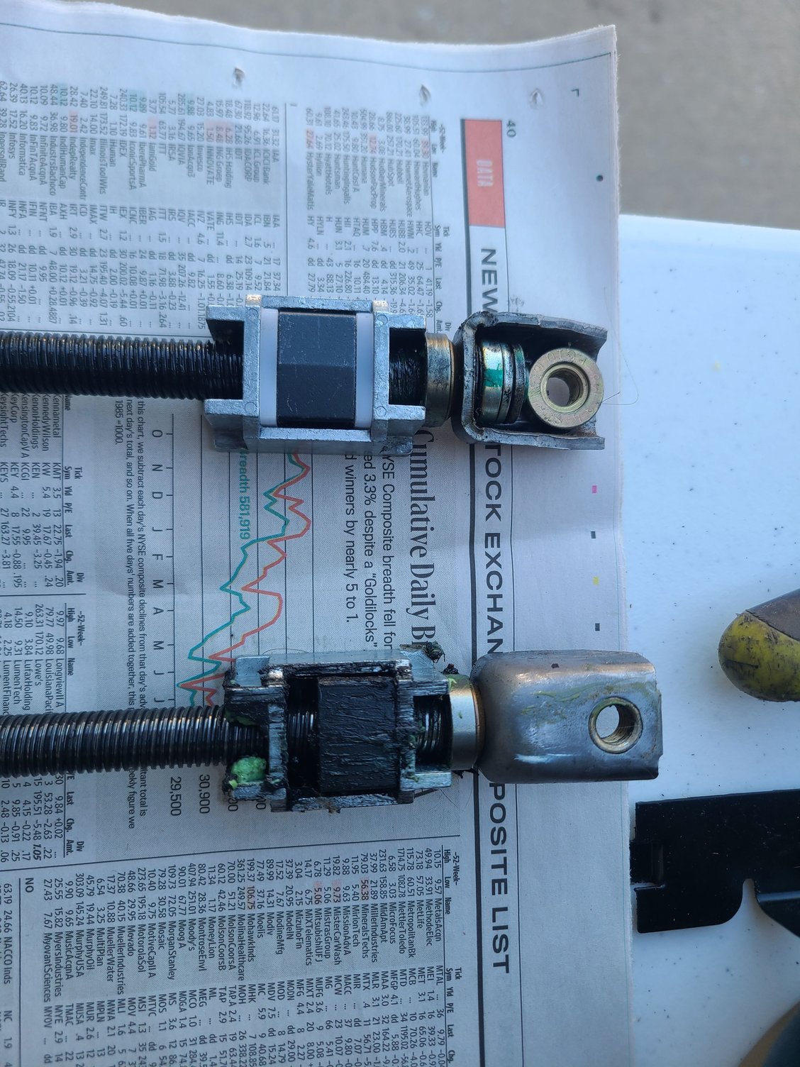

Bought the $10.99 bushings off Amazon. Had to sand a little to fit. Only took off enough so that they still had to be tapped in with hammer.
Happy so far...

can you link to the bushing? which part in the pic is it? (the seat has been getting on my nerves for quite some time.)

Sure. Here is link:
Amazon Amazon
The two light gray areas are the bushings.

To add to AJ's note...all that black greasy looking stuff on the wormgear housing (at the bottom of the photo) is the remnants of the disintegrated OEM bushings. They basically turn into greasy paste. These gaps are what allow the rocking to take place.
Fix is very easy just somewhat time consuming. (Worth every minute!) "How to" videos available on YouTube.

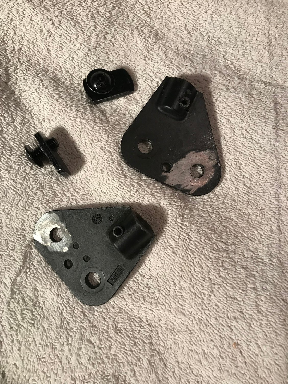

I installed the nylon spacers this weekend and found a ton of slop in the height adjuster pivots, as well as some endplay in the front worm drive gearbox. Links to a couple short videos. This is what's causing the rocking.
Pivots
Gearbox
I improvised some bushings to tighten up the pivots and that eliminated 90% of the rocking. There's still a small amount but it's much more tolerable and feels less like I'm sitting in granny's rocker. If it comes back when my bushings start to wear I might look at a pair of the billet pivots like vette4fl posted above. Pretty pricey tho.
One thing that really surprised me was how heavy these seats are. I don't remember my C4 sport seats being this heavy, but it's been several years so maybe they are. Woof!
