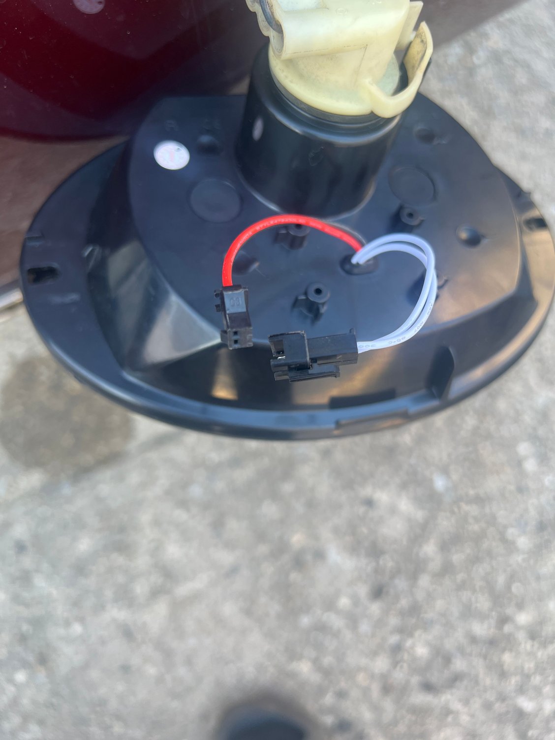

I just installed new halo tail lights in my 2003 vette I installed the hyper flash harness and I went to go start it today and my headlights went up and won’t go back down my rear side markers don’t work my halos don’t work my hazards don’t work and I don’t know what to do someone help please.
The halos had connectors on them. I do not know what they are for.

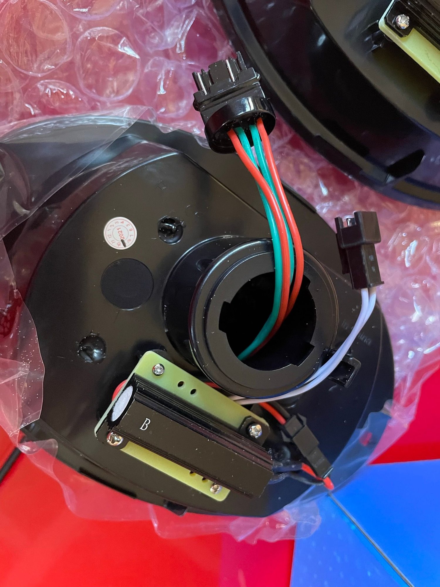

Your tail light looks to be missing the resistor. The white wires don't need to connect to anything but the red and black should be connecting to a resistor that should have came with them, like this
It looks like your resistors were removed as it should be secured at those 4 hole posts on the back.
Did you buy the tails brand new? If so, from where/who?

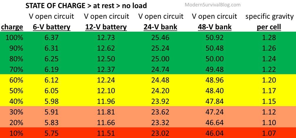

Old Jan 11, 2023 | 06:13 PM
jim993's Avatar
jim993
Joined: Sep 2009
Posts: 1,862
Likes: 594
From: Prescott, Arizona
Check this chart.
