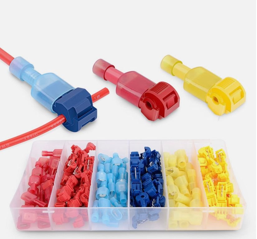

3. I initially planned to use T-tap splice connectors for tapping into my accessory and rear light as this would be easier than soldering them imo, and because I’ve never had a problem with them but I read some people said not to so I’m concerned. Is this not ok and if not, why?
