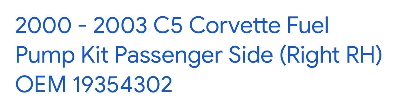

Are you absolutely positive the part numbers are the same for both sides ??…I’d research the passenger side part number !!

I believe so. An earlier post on here said the left one can be used for both if you swap and reuse the float arm from the left side.

That's the entire jet pump assembly. There's a larger thread on the subject here. There appear to be two wire and three wire versions on some early models, but most everyone with a 99 - 03 (with old style fuel system) has been able to use the 19421094 sender by swapping the float arm from the old unit.
