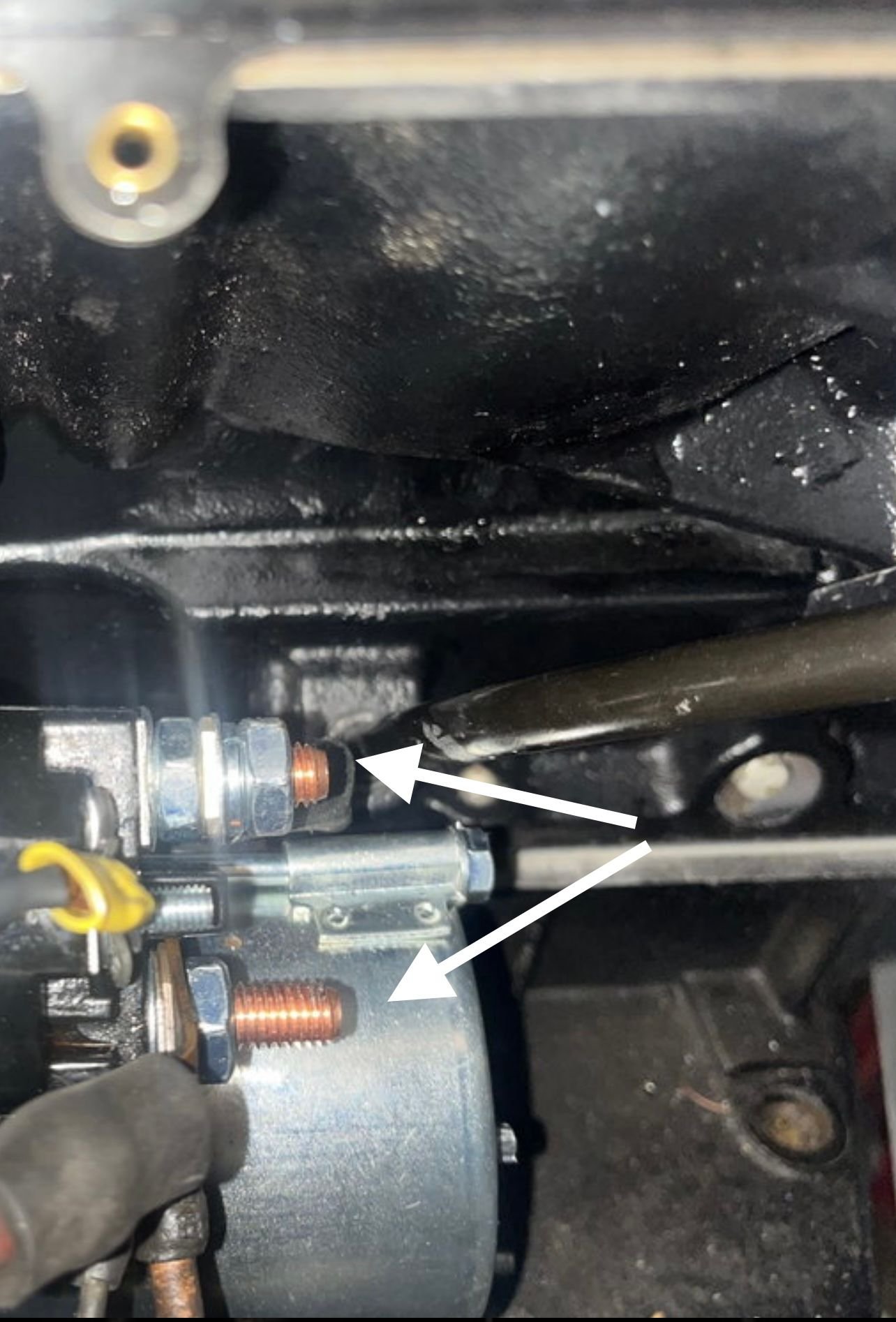

Originally Posted by pnwq60
I checked the two closest grounds on the front of the frame rails and the ground connections on the back of the head. Sanded and made sure of a clean connection. I have not tried "jumping" the starter. How would I do that?
The 2 grounds on the front of the frame rails have nothing to do with the starting system and the ground on the back of the drivers head are for the coil packs…the battery ground is above the starter and is on the block…and if checking is a visual inspection that’s not how it’s done…do you have a test light and do the check I mentioned??…if you have a heavier gauge wire you jump those 2 terminals in the picture….trans in neutral or park and e brake on with wheels chocked…you’ll be jumping power directly to the starter.
