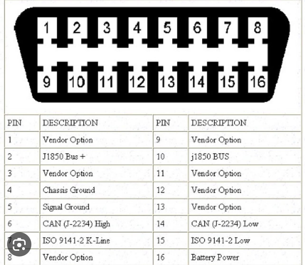

First I’d check for any stored trouble codes…If you’re seeing the fuel gauge going to “E” and the car is a “no start” or a “start and stall” I’m thinking a serial data bus issue…when all this craziness is going on there are a few ways to try to diagnose this but I don’t to disturb anything so what you can do is take a voltmeter and check pin 2 on the DLC…if NOT a data bus issue you will see the voltmeter dance around between .2 to .3 volts…if you see 12 volts (short to power) or 0 volts (short to ground) that’s not good….now you can disconnect the battery and using the ohm meter setting of your DVOM you should see more than 350 ohms between pin 2 and a good ground.

Basically what happens if when one of the cars modules lose power or a ground that power or ground back feeds onto the serial data wire and all hell breaks loose…you can look for any stored “U” or communication codes.
