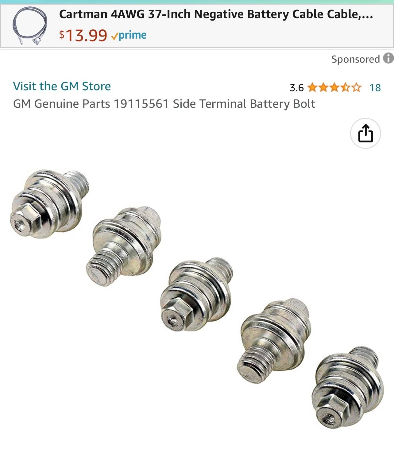

Like I mentioned if you have a DVOM check the voltage and make sure the battery bolts are clean and tight…if you do replace the battery it is a good practice to replace those battery bolts since they have a conductive coating on them.
