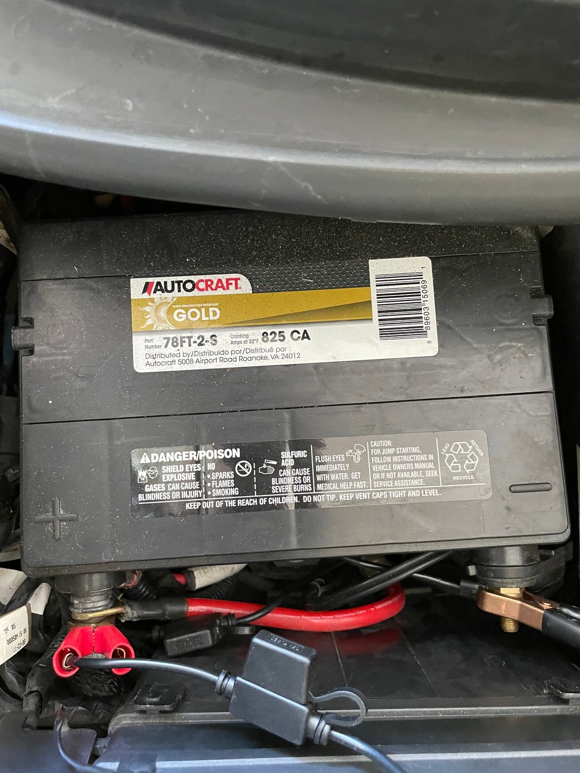

Min my 2000 Z51 the autocraft gold 78FT-2-S 825 CA battery died. I can’t seem to find this battery anywhere so now I must get a replacement. What battery should I get, should I opt for a AGM? What is the difference in reserve power 110, 115, 120 ???
How hard will it to install. ( pardon the tender)

this is what I have in 2004. You have side post so I would just look for the side post version. Easiest battery install. Just undo the hold down and pull out.

Guys...this is a dead battery...not putting a man into space . 13mm hold down bolt...remove hold down....10mm terminal nut loosen [do negative then positive]...remove battery...take it your parts counter....pay...reinstall in reverse order lol
I do have AGMs in all of my Mercedes cars...because THEY ARE REQUIRED AND CAME STOCK IN ALL OF THEM!!! These are Chevys lol. If you have a top post situation...and the extra coin...get an AGM if it tickles your fancy. If you like to throw your car on a tender over the winter months...get a lead acid battery. AGMs don't like a lot of amps and have to be charged differently.

if you look at the photo my battery has side posts with a few connections, does the bolt screw out with these connections then back in the replacement battery?
Yes. Uscrew NEGATIVE first...then Positive. Plop new battery in. reattach POSITIVE FIRST....then NEGATIVE cable. I dont like how long that negative battery cable bolt is. Maybe spring for a standard size side post terminal lug set while your at the part store. Unless, there are other negative connections I'm not seeing.

ok thank. The post are long due to added electronics the previous owner had installed (amp, sub) in the truck floor. Was making sure none of the vetted electrics will be affected. Guess I will see when I call up codes. Never had battery with side posts, I will try to replace myself. Lastly so no more trickle battery tender??
