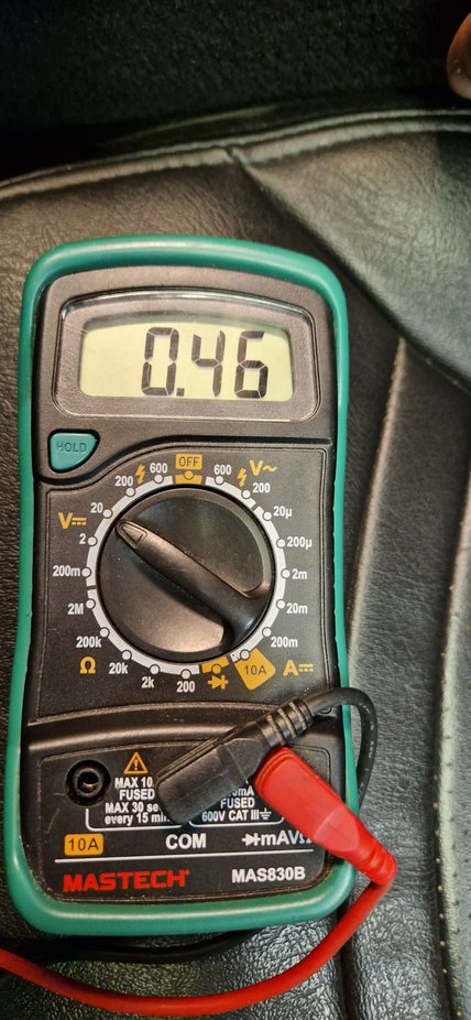

Here's what the voltmeter says with your instructions:
So the readings seem to okay, right?

1.2 volts doesn’t look good if you are on pin 2 on the DLC with key ON…if you can remove the combs from both splice packs check the voltage readings on each wire with the key ON.
