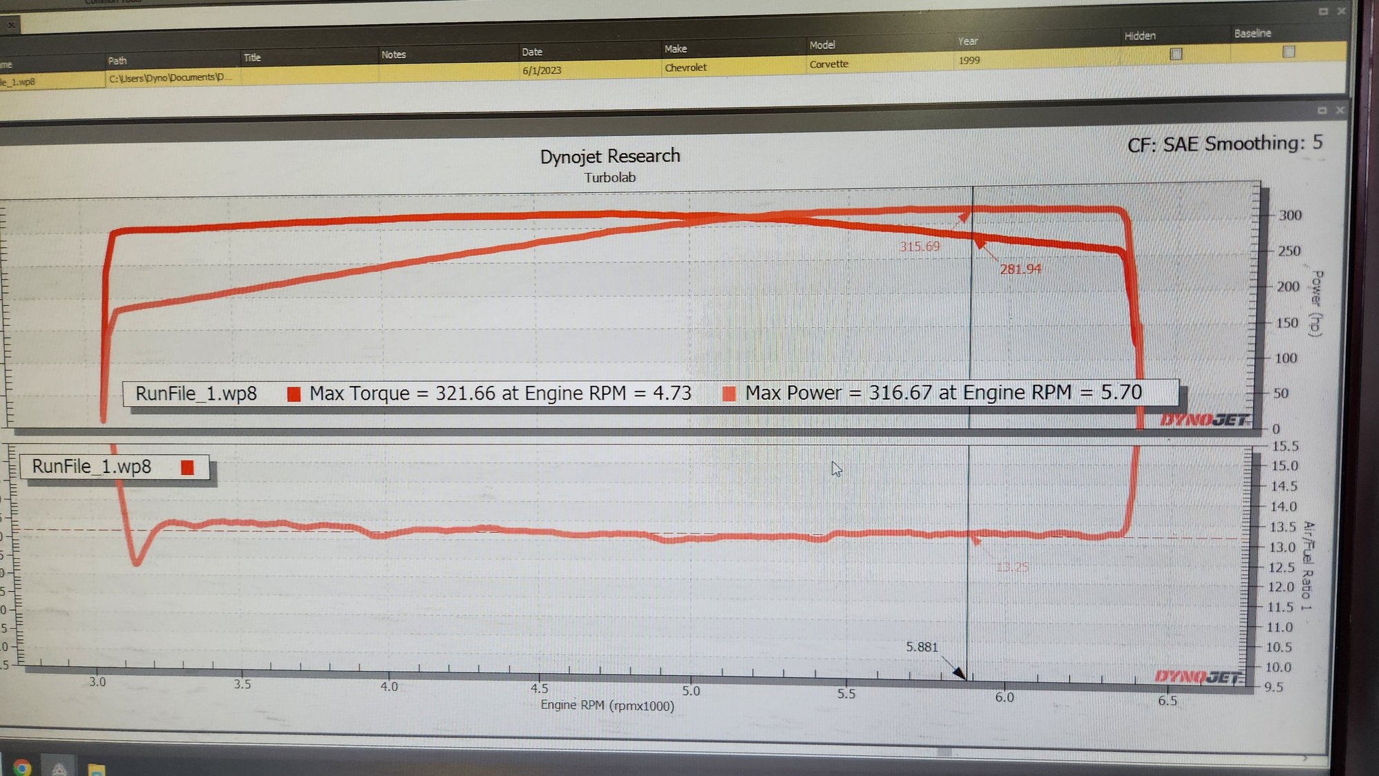

This was my baseline before any mods. With just a Donaldson cold air and a Dynamax Super Turbo axle-back, I am only losing 28 HP through the T56 and stock manifolds. Not bad for a 24 year-old car!
So, based on this pull, I only need to pick up 83.3 WHP to get to my goal of 400 with the parts I listed above. Shouldn't the stage 3 cam alone put me in that ball-park?
Anxious to see any feedback here.
D
Edit: Added 36 lb injectors to the mix. Being the stock ones are 26 lb and 24 years-old, I just upgraded and won't look back.
I am really hoping the tune can make this rig driveable and still make me 100 WHP gain. If not, 3.90s might be on the way.

Old Jun 8, 2023 | 04:04 PM
grinder11's Avatar
grinder11
Posts: 12,864
Likes: 4,667
D
I don't know if the cam alone will get you in the ballpark. I'm thinking at least 60whp, with supporting mods....a lot will depend on the "stage" 3 cams specs. To reiterate, if you have to pass a sniffer, I doubt very seriously you'll pass. But, I've certainly been wrong before. For reference only, I have a 232°/250°, .610" lift, on a 112 LSA Futral by Cammotion cam in an LS7. Even with the bigger cubes to help "tame" the cam, no inspector worth his salt would pass my car. The idle alone, while not super radical, is far from stock. Good luck to you.........
EDIT. After seeing the CNC 243s, I was about to say I'm pretty sure you’ll make it. But now that I've read your post, and seen averagejoesautos reply about you running your stock exhaust manifolds, I'll now say no. I agree with averagejoesautos, that the exhaust is going to cork it up pretty good. Running the stock manifolds on an engine like this is like baking a great cake then shorting it in the frosting department!! This will be even worse if running the early style, '97-'00 manifolds. The '01 and up are a bit better, but not good enough for what you're doing. If you do this, it will certainly run much faster than stock. But your engine will be one of those engines you've read about that will gain 50+hp when you go to headers. My .02.....
So, help me apply a little logic here. If my baseline Dynojet had only lost 28 HP between the crank and the wheels, (a loss of 8.5%), and I add another 100 to 125 HP to the crank.. If the scale were linear (which I know it's not.. it's more about flow and vacuum scavenging). Even if I lost 10-12% after the mods, I would still mathematically come out with around 413, which is about where I expect to be.. Does this logic not apply? I am seeing in other posts where cat deletes are only picking up about 8-10 HP, so I am assuming based on my own dyno that the stock manifolds and cats actually do flow fairly well. The tuner doing the work said he would be more concerned with the extra flow blowing them out eventually. At 24 years-old, he mentioned that it might even happen on the dyno during a pull..

Here is where I am today:
Engine is out of the car, here are the parts I actually could get:[list]
  • AFR as cast 215 Mongoose heads
  • BTR Stage 3 cam 231/244 .630″/.615″ 112.5+2.5 with titanium retainers and .660 lift springs
  • BTR 1.7 rockers with trunion upgrade
  • LS6 Intake
  • Alphainjection 550cc fuel injectors
  • Front and rear main seals
  • Billet double roller timing kit
  • Melling high volume oil pump
  • New NGK plugs and wires
  • Exedy Stage 1 clutch assembly
  • Tick master
  • GM slave
  • HP tuners Dynotune
    Still gonna be stock LS1 manifolds H-pipe, and cats with the Donaldson CAI, Dynomax SuperTurbo axle back exhaust.
    Still hoping to pick up about 80-85 WHP without the headers. This would put me at about 450 at the crank, and hopefully 400 at the wheels. I am supposed to get it back Wednesday, but I think it will be more like Thursday, maybe Friday.
Old Jun 17, 2023 | 10:53 AM
dainon's Avatar
dainon
Joined: Jun 2021
Posts: 257
Likes: 75
So, I got the new heads and cam installed, picked up the car from the shop last night. As I was driving home, I started noticing what I thought was clutch chatter, like maybe a throw out bearing or something. But this morning, I put about 50 miles on it, and it has gotten worse. It's definitely a tick in bank 2, probably in number 6 or 8. It's most loud at 1800-2000 RPM in 4th gear.
The lifters, trunions, pushrods, springs, valves, etc. are all new. I'm going to have to take it back to the shop on Tuesday after the holiday weekend. Do I need to park it until then? Am I damaging anything? Or is this just some kind of break-in period where something needs to seat or settle down?
Thanks for the look,
-D
