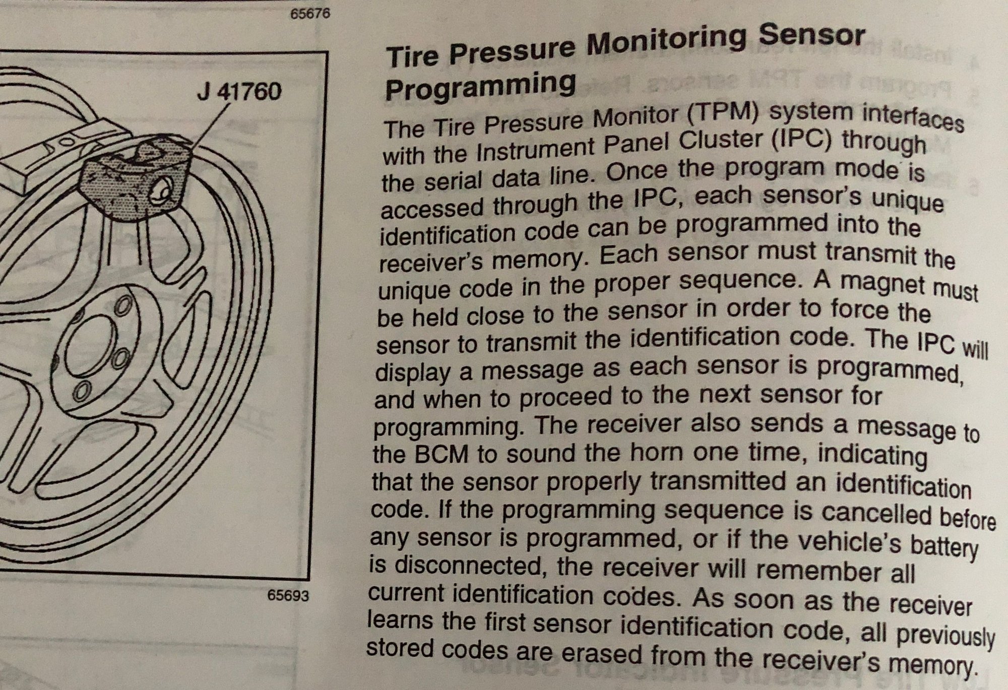

Originally Posted by Dodgeturbpo
My 2000 M6 since I had it 2 years reads 0 on all tires. The previous owner put new tires on it and didn’t know anything about the sensors, now the dumb question how do I know if they are even on the tires and if they are I read you just use a magnet to set them up. Shorty after I purchased it I had a low tire notice pop up but it was right on pressure
Here is the programming process from the 2000 service manual. I THINK the tool is just a magnet but you might want to check that.
Also- OEM sensors did respond to a magnet but not every aftermarket sensor does. Read through some other threads here for alternate methods.
