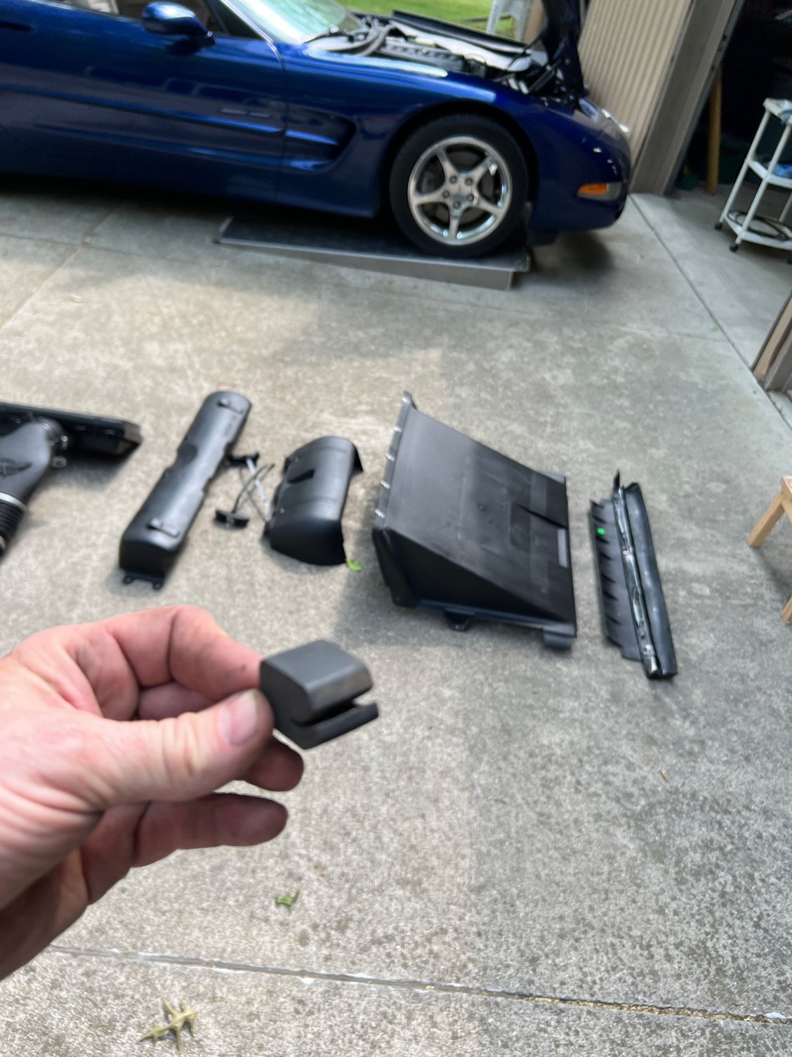

Last week it was near 90 in Detroit and I noticed the temps creeping up to 230-240ish when sitting in traffic. Checked fuses and fans and all seem to be working.
where does this rubber block go?
I've only owned this car for a year and read on this forum about cleaning out the debris under the fan shroud. It was about 1/3 blocked, so I removed the air cleaner and shroud and cleaned everything. Seems to be running much cooler now. Anyway this piece of rubber fell off while removing. Does anyone know where it goes?

It goes right about there to protect the hoses that come out of the radiator

CI 6,7,8,9,11 Vet
St. Jude Donor '08
Look for the RED ARROW in your pic YEP!
