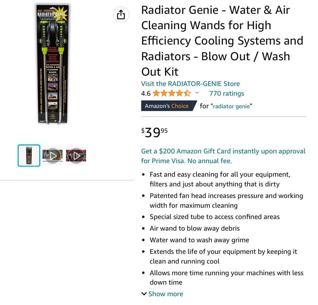

Main cause and most overlooked is cleaning the radiator and condenser fins. You can get the big stuff out from underneath just using a vacuum tube, but removing the top cover, 4 bolts, gives you access for wands; both air and water.
The engineer might be “right”, but I wouldn’t drive in 100° heat with the heater blowing, lol, so turn on the AC to keep the fans running.
Radiator Genie - Water & Air Cleaning Wands for High Efficiency Cooling Systems and Radiators - Blow Out / Wash Out Kit https://a.co/d/4vvuj76
