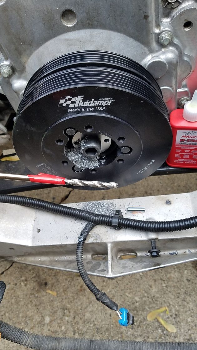

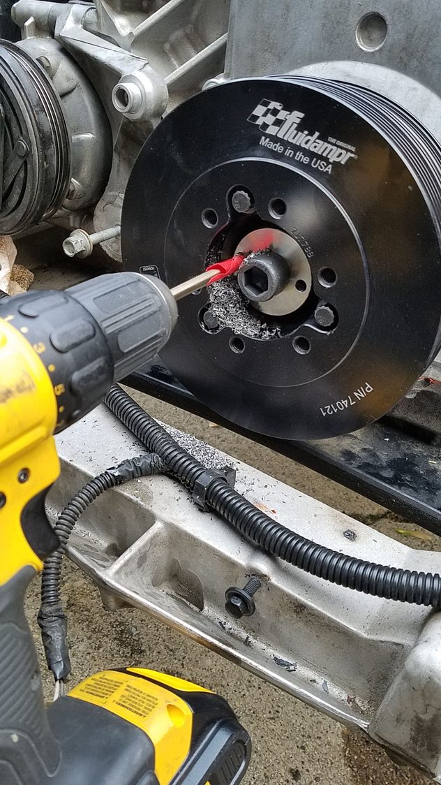

I can lend you the tools if you pay the shipping back. While not completely necessary. I did mine. Really easy to do.
