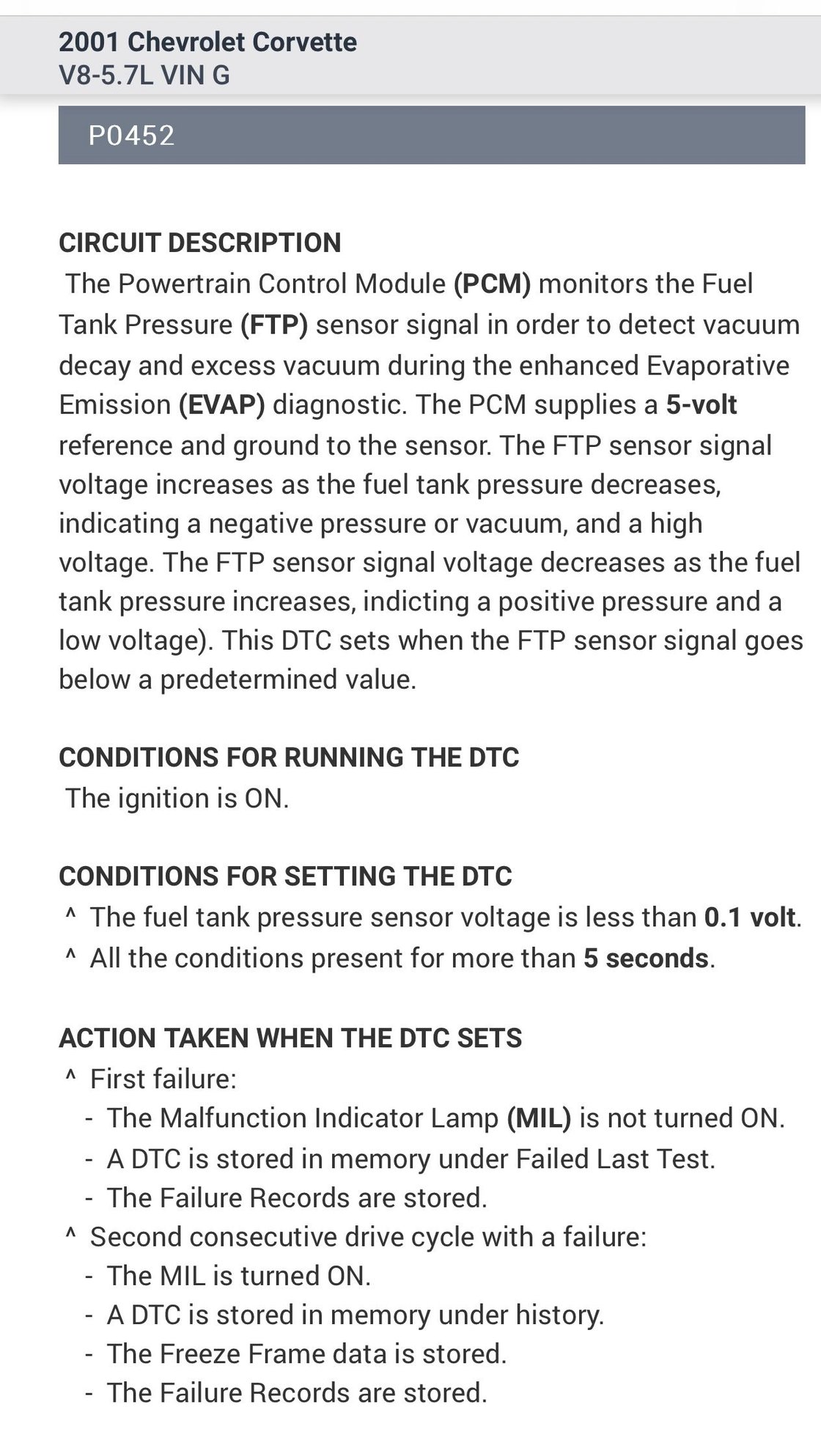

I have a code DTC P0452 Fuel Tank Pressure Sensor Circuit Low Voltage, if I have to replace this sensor after I do other checks is there any way to get at it or do I need to drop the tank??

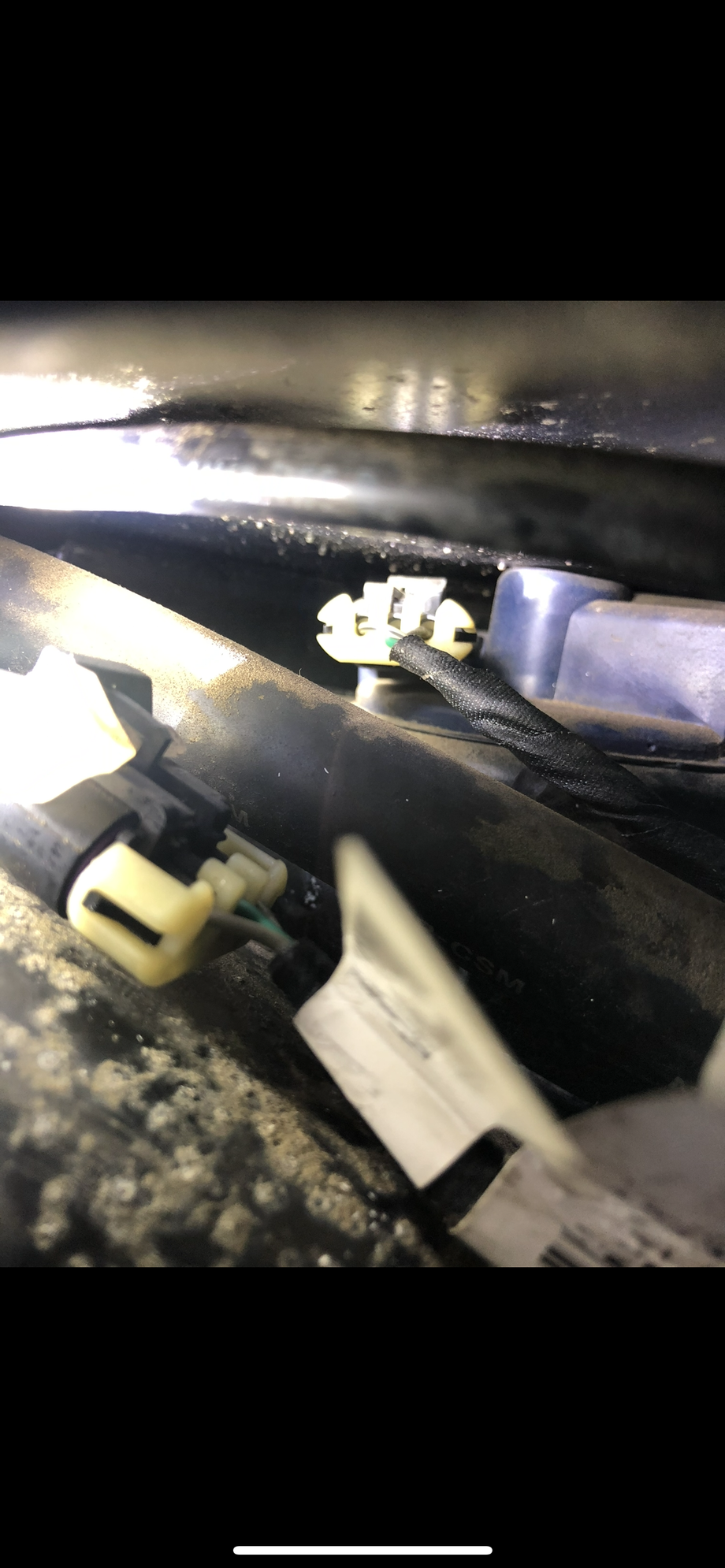

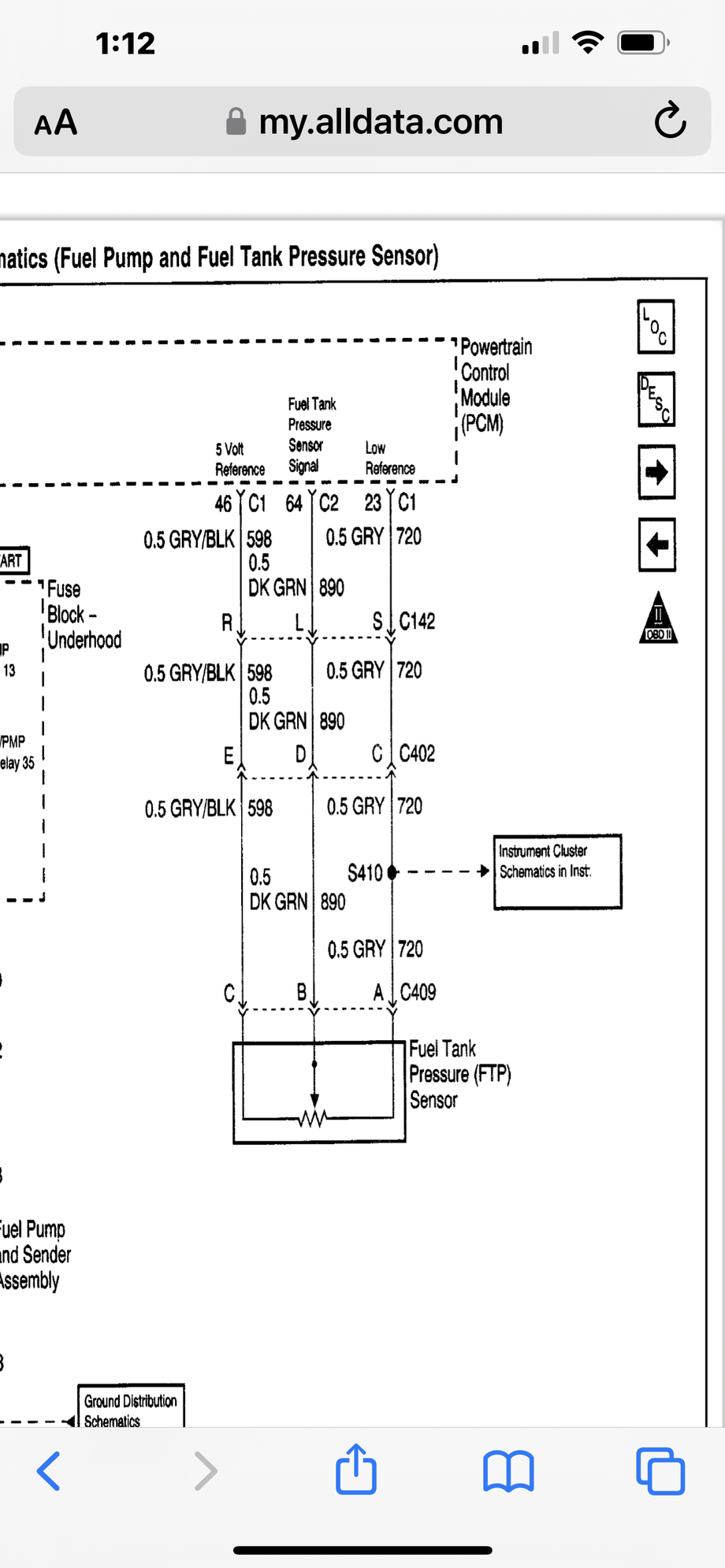

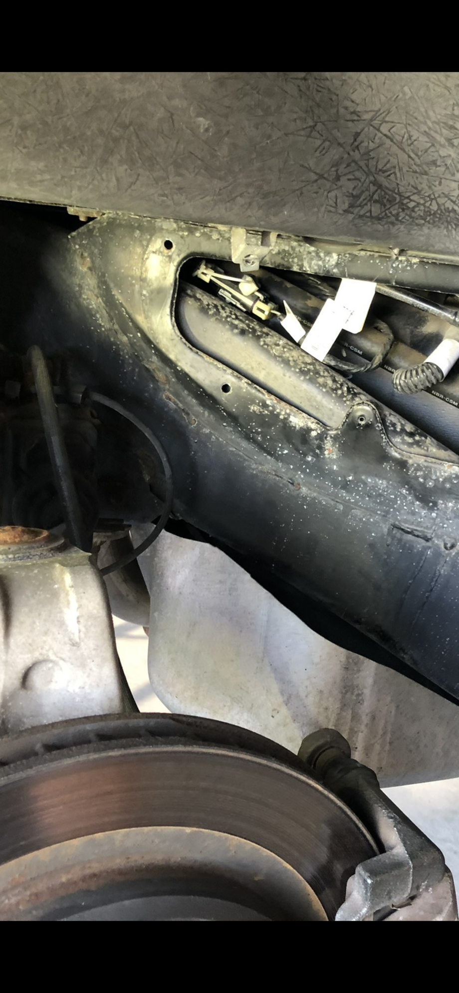

It is on top of right hand fuel tank…procedure below and location but don’t always assume it’s a bad sensor…you can have a wiring issue but to isolate the cause it’s best to use a DVOM and a scan tool where you can see the fuel tank pressure sensor voltage…you will normally see around 1.5 volts on a good sensor with key on engine off…you might not have 5 volts on the gray/black wire or the green sensor wire may be open or shorted to ground…it is a good idea to fill out your profile with model year, trans type, mods, tune etc so we know what we’re dealing with.

Hardest thing would be getting the right rear tire off…good luck and if you need further assistance let us know !!
