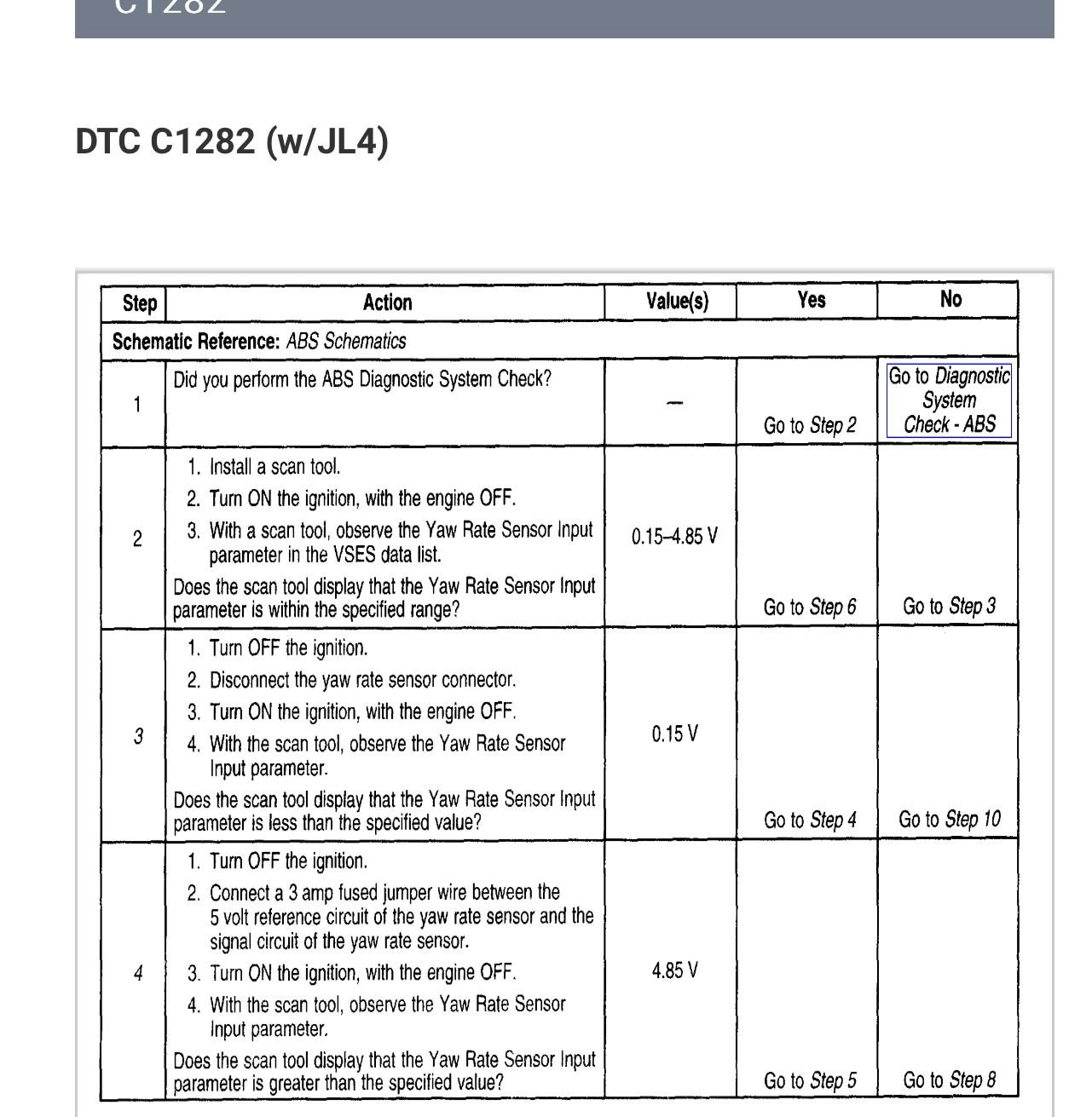

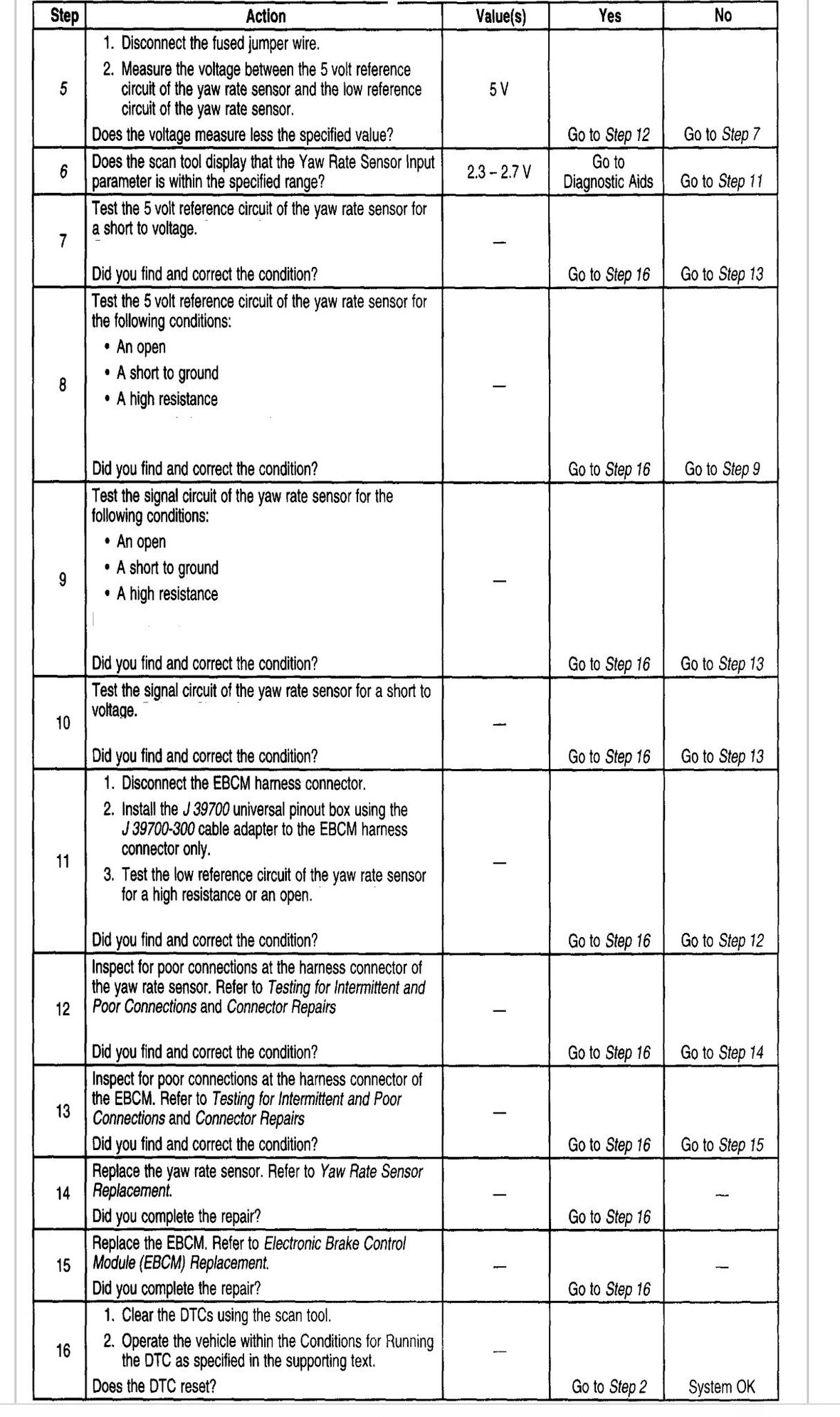

A visual inspection is not good enough !!…you will have to transition from being pretty mechanical to “electrical” !!…diagnostic tree below !!..NO programming needed !!
